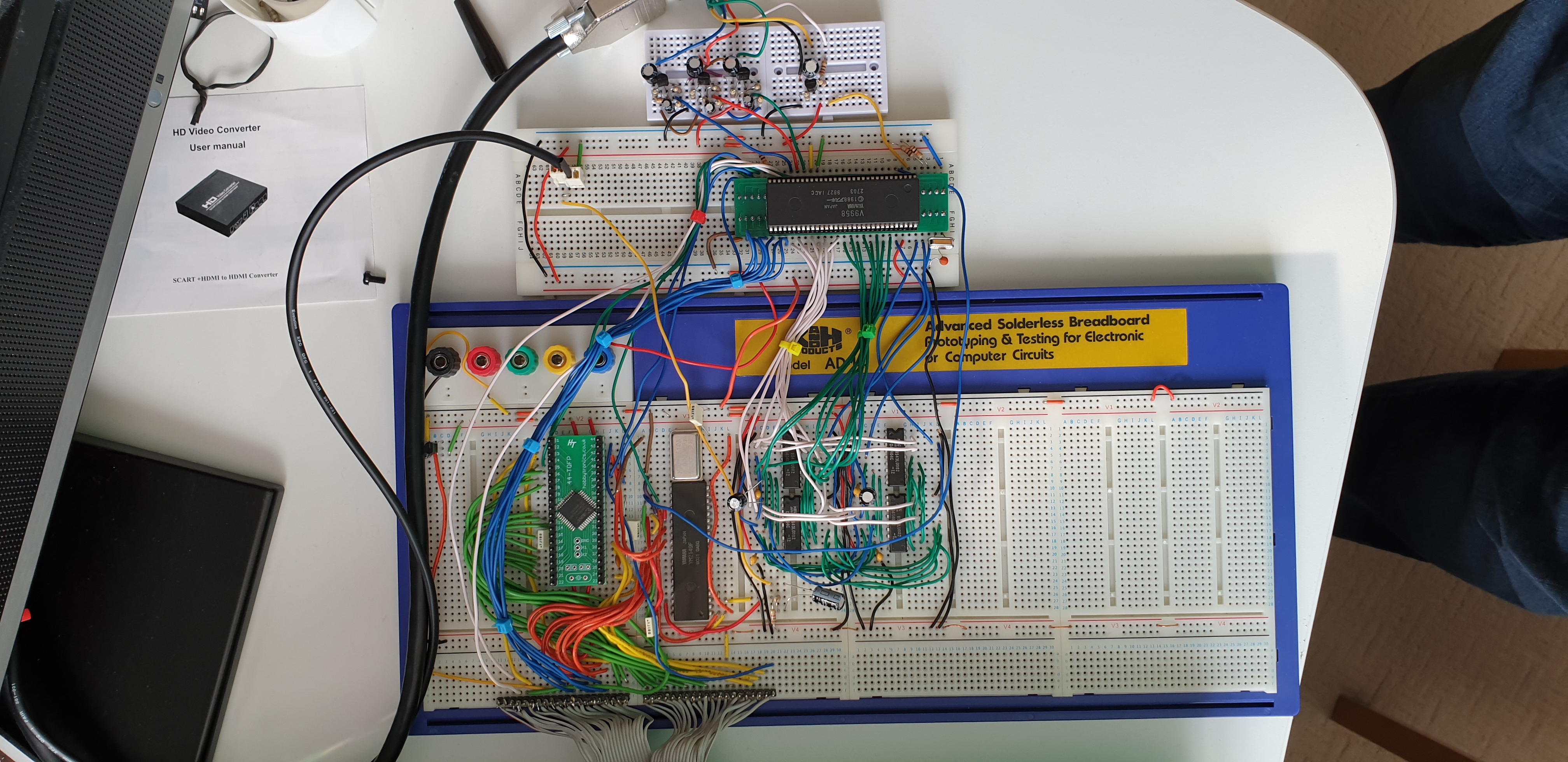

And here is the prototype audio and video circuitry.
- 15899073068146553050235270359487.jpg (2.42 MiB) Viewed 14766 times
Re: Using the Wordpak2+ on the Dragon
Hi John
Great job, congrats!
Can't wait to test one of these modules using both video and sound!
