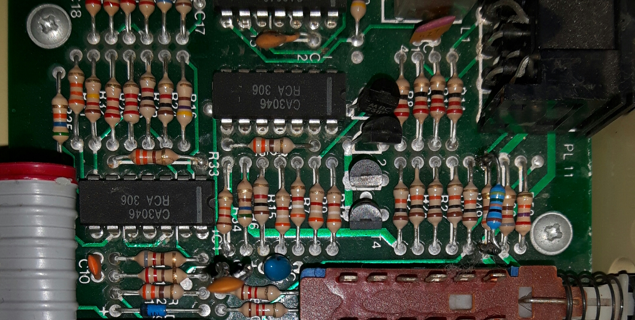

So you have a Dragon 64. When I look at its schematics, I see a LM 7905 in the video section.
The diode is a clamp diode, any one is good for that like 1N914 or 1N4148. Mine is a little blue one.
https://en.wikipedia.org/wiki/Clamper_(electronics).
On my Dragon, this circuity is part of the power board, where, for your Dragon 64, it is empty near the DIN connector.
It seems possible to put a little PCB above this area.
I don't think it's a good idea to remove all the signals of the VDG ?

Thanks for the information about the diode, I was already thinking of putting a 1n4148 diode but you have confirmed it, I am not going to remove the vdg chip, since I have seen that it is already soldered on the board, I have an American tandy coco 2 and it has a socket and I had in Mind the one with the vdg chip socket.
I will change the strategy in the placement of the rgb pcb.

As I explained before, the SECAM circuitry with the tunable inductors and delay device is on the mother board. I have not yet published its detailed schematics. It would be only for fun ! Is there anybody interested by a french SECAM circuitry ?
On the power board, we have the RGB conversion with the transistors included in two IC1 and IC2 (CA3046) and the resistors, caps and diode around. Plus the four output transistors.
Near this, you can see another IC3 (CA3046) and a tunable inductor, that's a rather complex circuitry for sound to the RF modulator.
So the RGB pcb is very limited, with a very classical circuitry.
I have also got a Tandy coco 2b with a RGB output. The quality is better, it should be interesting to copy that circuitry too, but not as easy to do as for the Dragon one.
There are also some (only french ?) Dragons, related in forums, with a piggy RGB PCB.

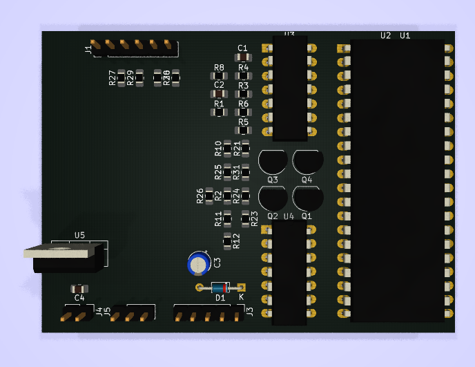

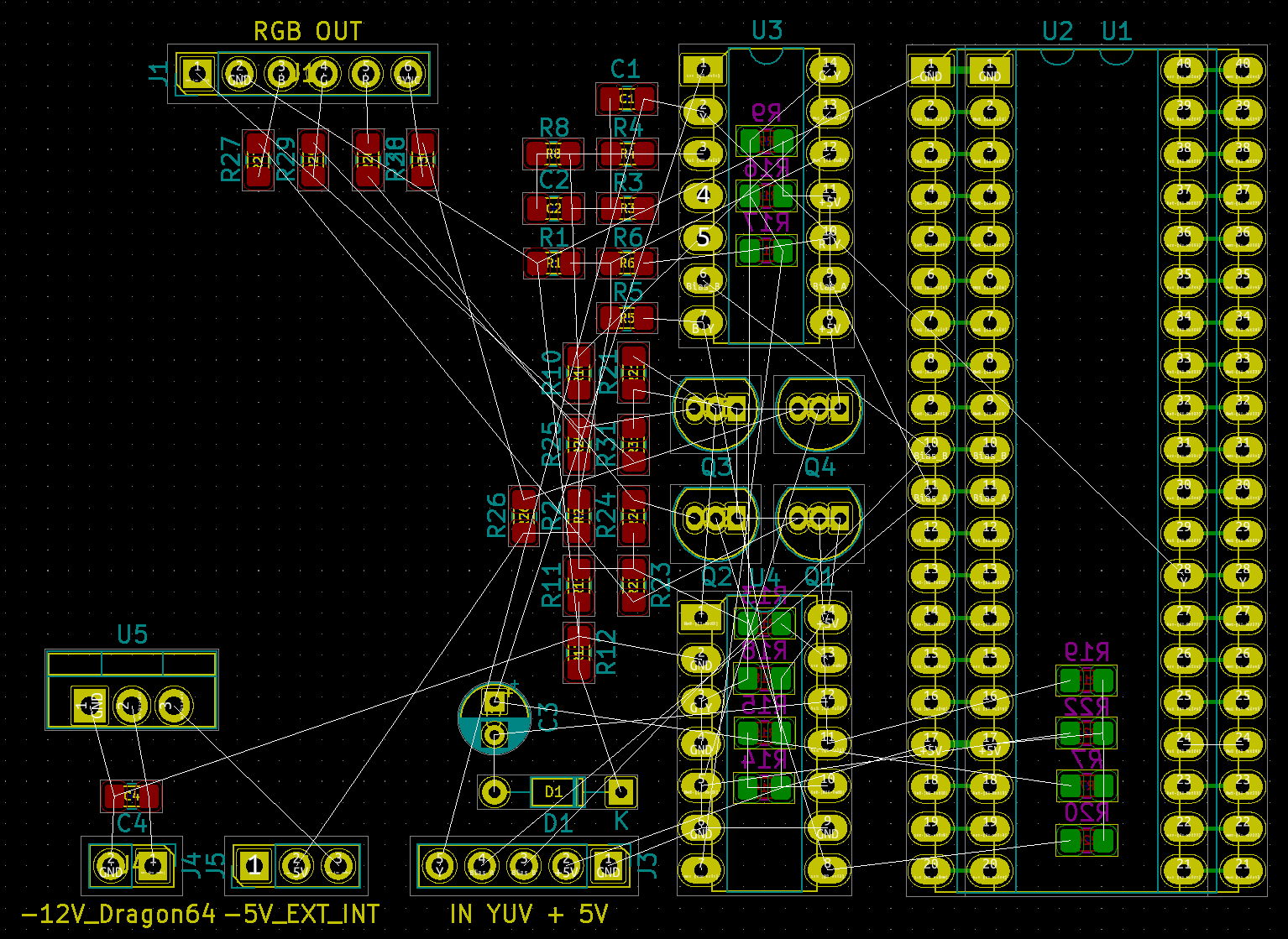

Greetings, I enclose the prototype pcb of how the idea of removing the RGB signal from Dragon32 / 64 would be, I have tried the following idea:
Integrate the board into the VDG, but as is being discussed you have to unsolder the VDG chip.
integrate the YUV signals by cable method without actually desoldering the VDG.
Integrate a 7905 linear regulator to get the necessary voltage -5V since the D64 does not have this voltage.
Voltage selection -5V either external or internal since the D32 does have -5V voltage.
- Captura de pantalla 2021-09-15 a las 11.12.46.png (266.21 KiB) Viewed 18877 times
- Captura de pantalla 2021-09-15 a las 11.12.31.png (294.08 KiB) Viewed 18877 times

Hi retrocant and everyone else here...
Interesting board idea and documentation of the original SECAM RGB stuff. I've a question though... How does the original SECAM board circuit get its luminance signal? It can't be direct from the 6847 as there wouldn't be properly formed 'extra PAL' lines?
A board using this approach would surely need to steal the luminance after the extra lines mixing, not direct from the 6847?
Maybe you're already coping with that though and I've misunderstood?
