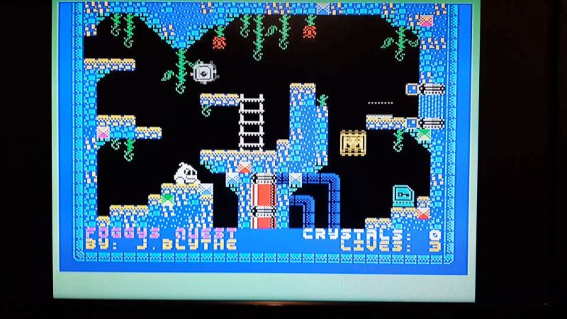

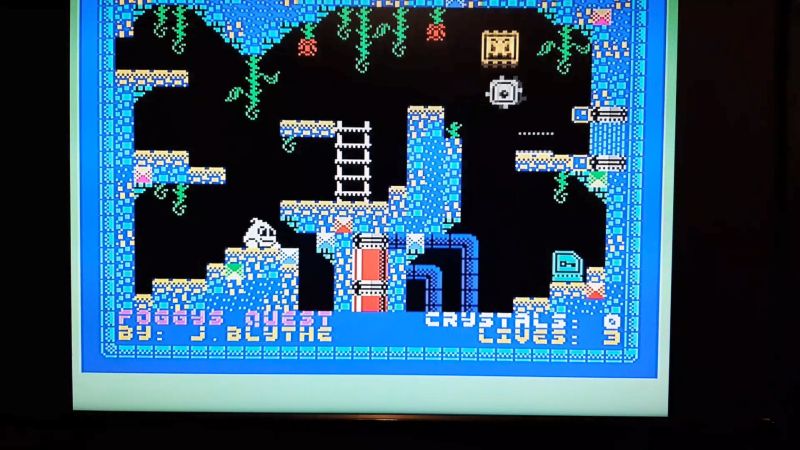

I have been working on the test game Foggy so that now I am able to draw the pannel surrounding the play area
and can also give colour to a sprite and the key, just how they show on the original game.
This is almost the end for testing purposes. Now I need time to analyze seriously how to convert the AGD engine
to this little monster: Dragon-6309-MSX2+ and then decide if I dare to begin (and finish) that project ;-)
Will keep in touch.
On the other side I have three more image converter programs to test. I have downoaded them, so I should devote
some time to convert the eight test images in order to discover which is the best converter on all the resolutions
I have been using.
And now, here you are a video showing this very last version and two screenshots too.

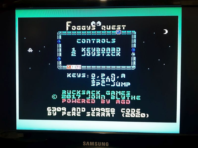

Right now I am working on the subroutines used to show text on the screen background
To test as much as possible, I have chosen the intro screen for Foggy's Quest, I attach here an image
Not so easy as I would have expected, so I need to rework some 'engine' parts
