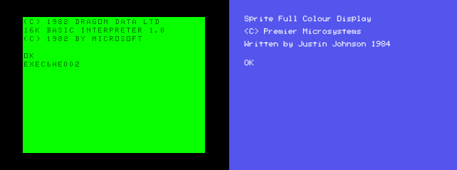

Here we go...
Took a little more effort than expected as the current implementation of the cartridge interface is read only for the CTS region $C000-$FFEF. So also needed to make this more flexible to allow writing to the TMS9929A at $E000-$E001.

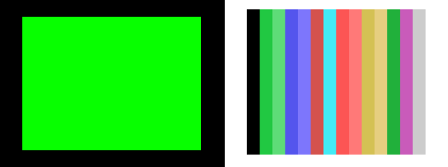

Colour bar pattern from manual:

That's fantastic! Given that the DU article didn't have any screenshots, and that Premier went bust right when the article went to press, that might be the first time anyone outside of Justin Johnson, Premier and Brian Cadge has seen it :)
