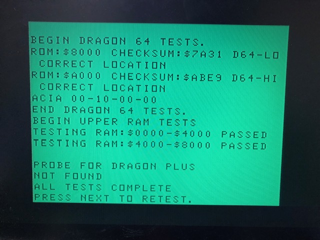

Still not managed to figure out the glitch glitch, but I figured I'd test it with Phill's diag cart.
At first it completely failed! But once I removed the special-casing of $FF3x:

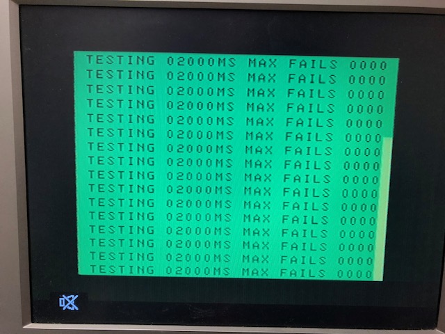

Re: SAM replacement - nearly there
After a note from Stewart, the refresh tester output seems to be fixed (and along with it the transition from slow to actually-fast mode).
Posts: 1436
http://www.6809.org.uk/tmp/samx4-wip/silky.mp4
I'm not especially keen on what I had to do to make that work (delay video mode register setting by two full cycles!), but work it does.
So bar it turning out that it's screwed something else up by doing that, I'll try and prep the source etc. by the weekend.
Posts: 1436
I'll just add that without a testbench that Stewart whipped up, fixing that would have taken a _lot_ longer, so thanks a lot, Stew!
