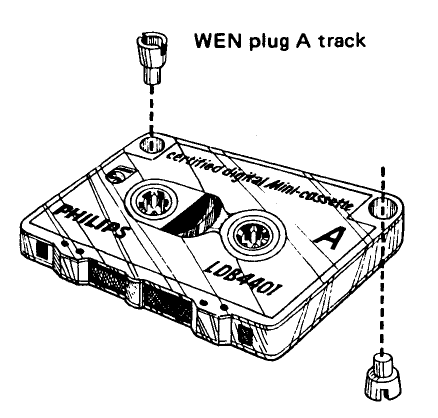

Write protect - I couldn't get writing to work at all, with the drive just reporting ?WP Error.
It seems most analogue mini cassette recorders using the Philips mini cassette - dictaphones etc - don't use the write protect feature. Whereas the digital drive does, and requires the little round holes at the top of the tape to be covered in order to permit writing. It seems Philips supplied little plastic plugs to push into these, but covering with a bit of sticky label or tape will do fine.
Write Protect plugs.png (24.67 KiB) Viewed 65432 times
Writing is now occurring, though it is not at all reliable. I've cleaned the heads thoroughly and that hasn't made a difference.
This might be a calibration issue. There are electronic tape read signal "level" and tape speed calibrations, and a physical jitter calibration screw. Apart from the tape speed though, dedicated test media is needed to perform the calibration procedures. I suspect jitter, as old recordings seem reliable but new ones not - neither read level nor tape speed should have this effect. It might also be damage to the internal drive gears from attempted jitter adjustment in the past :-/
I don't think it's a media thing either - in theory these should be used with dedicated LDB4401 digital mini-cassette media, but writing to either an old digital tape or a new dictaphone one seems equally unreliable.
