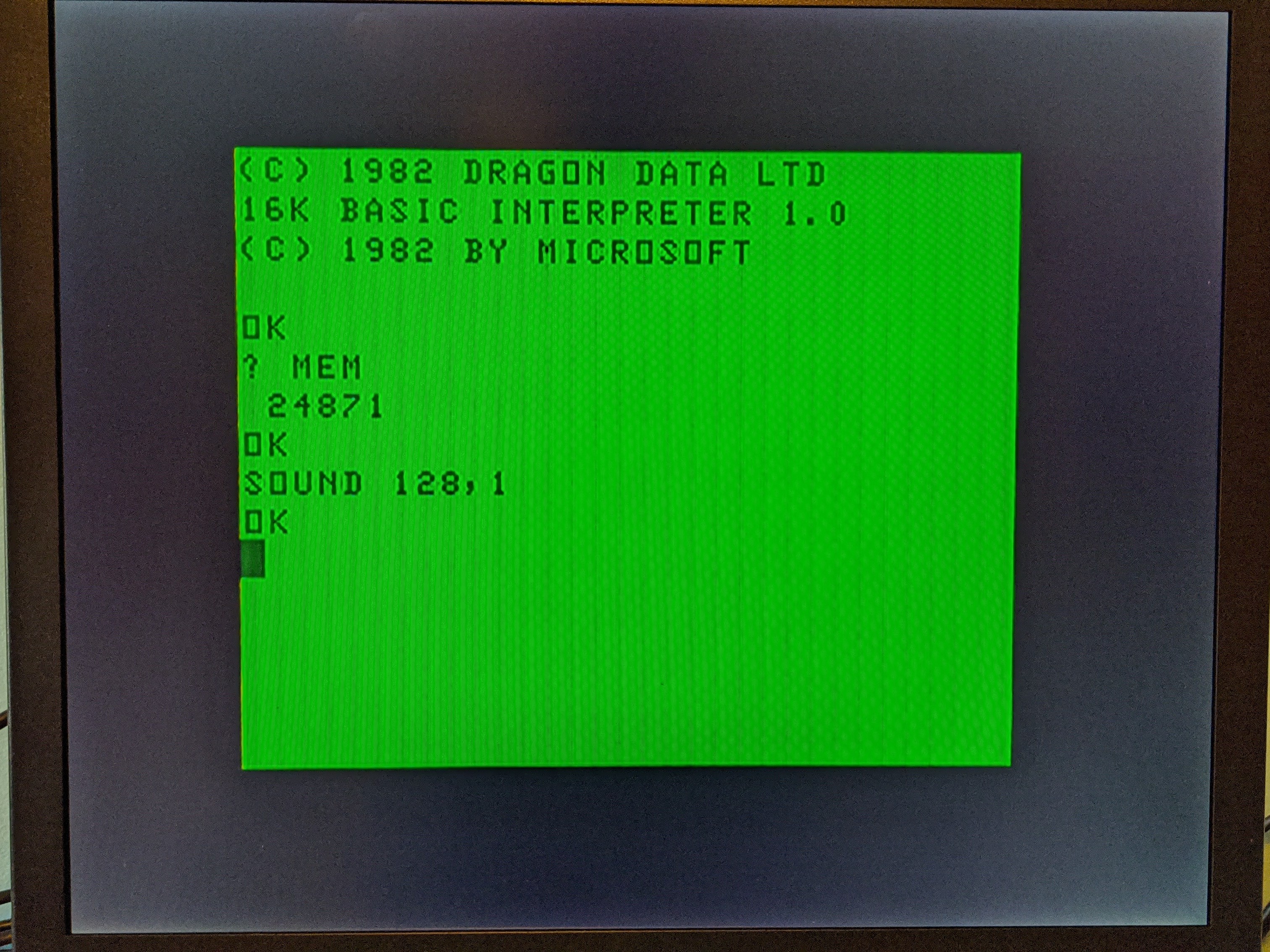

I'm now somewhat convinced that this is an analogue side issue. I've managed to test the unit on a different screen with built in composite (previously I was using a composite to HDMI adapter). This has stayed 'green' for a good half an hour. My guess is the adapter, being a cheapy, is being a bit more fussy about the composite colour subcarrier. I might still do some recapping in the hope that I can tighten up the signal specs, but I guess the real lesson here is watch out for cheap composite converters.

I'd be interested to see how the Retrotink works out. In the meantime I now have a proper green screen but a couple of annoyances remian. The colours are a little washed out I'm getting some 'bleed through' of the image to the right of the centreas well as occasional very short flickers. Would it be worth fiddling with RV1 and if so are there any dangers?
