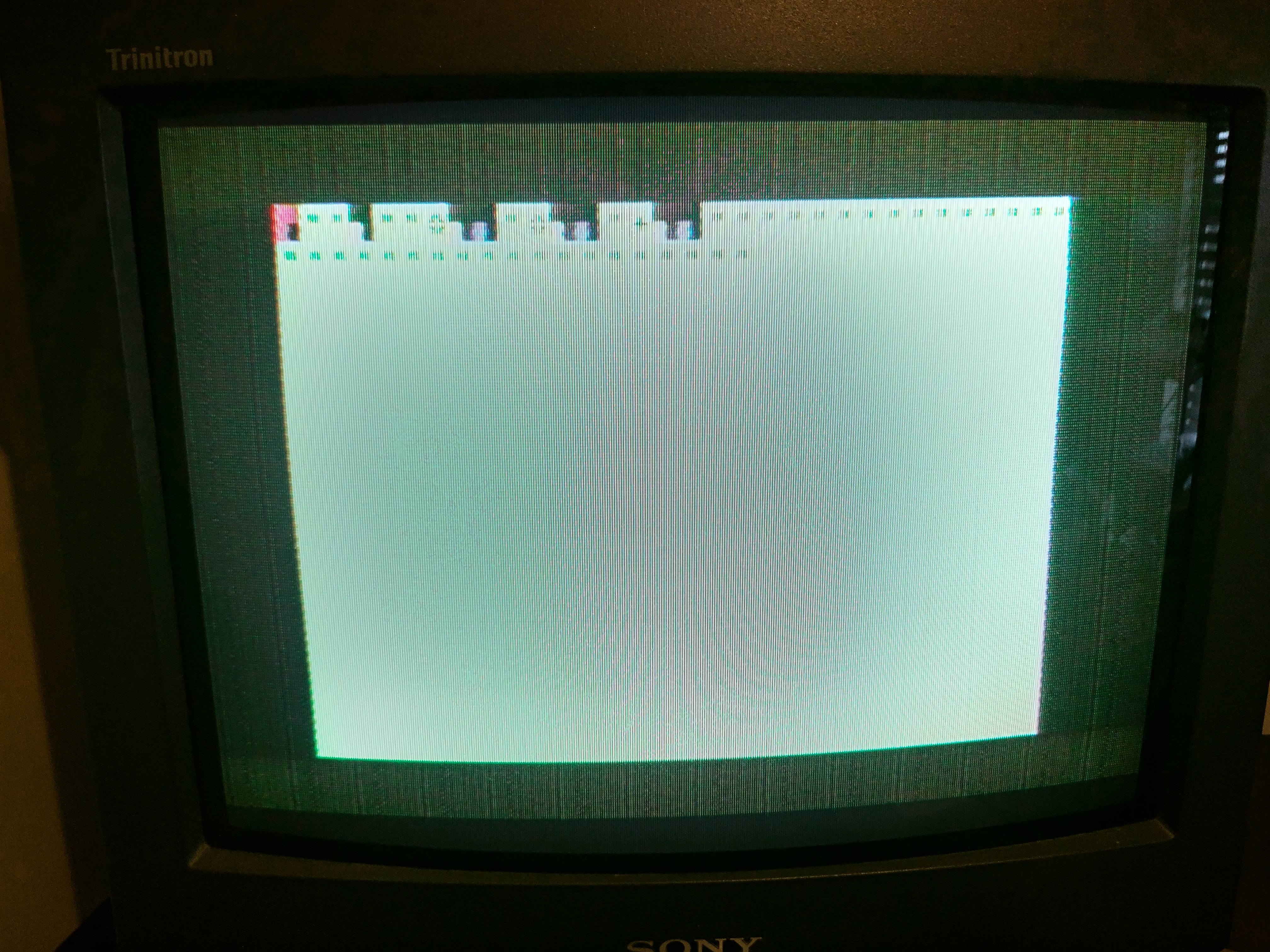

I have therefore been attempting to repair it. It produces a green screen on startup with a few characters.

Hi, and welcome to the Dragon Archive!
Could you post a picture of what appears on the screen. Just to check because certain error patters are quite recognizable.

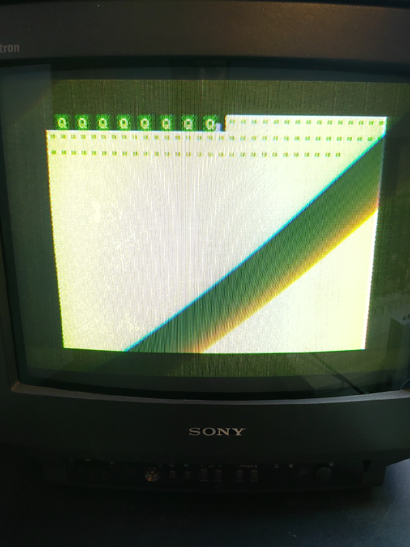

Here is a screenshot of the display on startup:

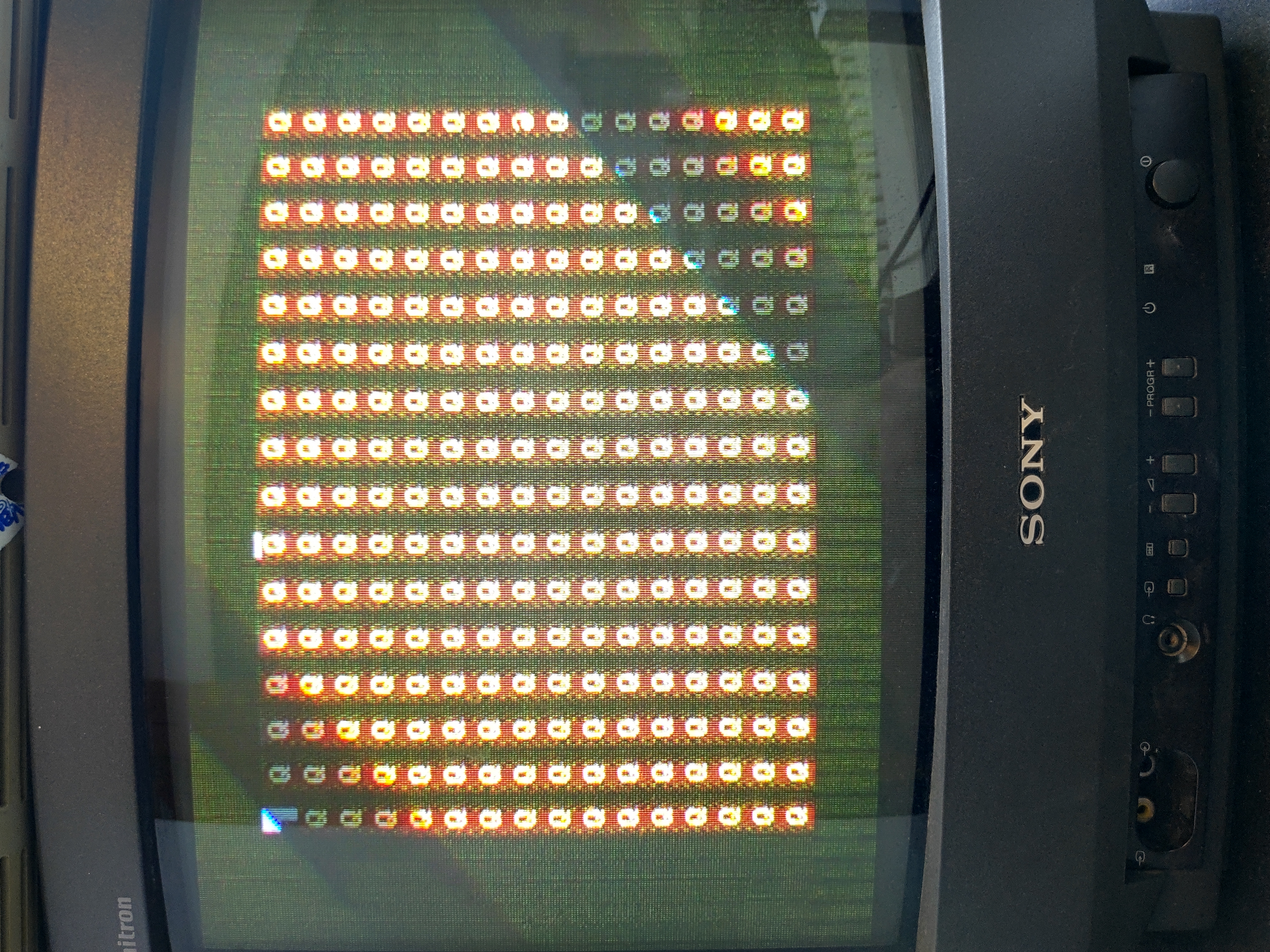

This is the 32k screen: ...and after 30 seconds I hear a click:

The screen with all Q's looks like it's been jumping around memory and hit the CLOAD/M functions, which would clear the whole screen, make the relay click and put the cursor on the top left corner.
Looking at the schematics (http://dragondata.co.uk/tech/circuit-diag/index.html), and assuming the CPU (6809), The SAM (Synchronous Address Multiplexer, 74LS783N), the RAM chips, the ROM chips and the video chip (6847P) are OK, there's only IC25 (74LS244) and IC20 (74LS273) that have anything to do with RAM access.
I think that IC25 may be the most suspicious of these two, but both can be actually failing...

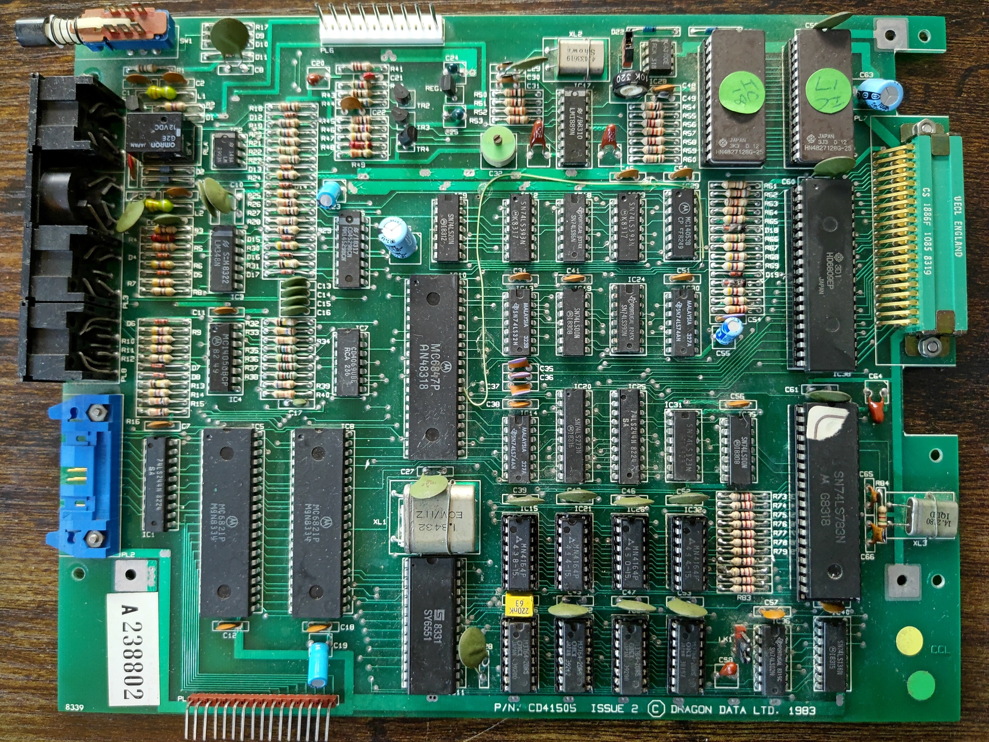

This is my board: By the way, I have also been told that a faulty 6821P (keyboard controller) can sometimes also cause such errors...

Oh, and would you be so kind to take a nice picture like the one you posted but of the solder side of your motherboard?
Turns out, we have a revision 2A board but not yours
