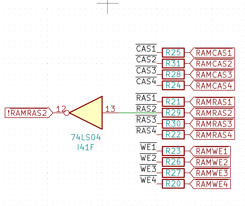

I have doubts about some resistors that I don't know what the value is; They were the following ones:
R25,R31,R28,R24,R21,R29,R30,R22,R23,R26,R27 and R20 since in KICAD there are not the values of certain resistors.
Thanks.
Thanks.

retrocant wrote: Sun Feb 26, 2023 9:05 am I have doubts about some resistors that I don't know what the value is; They were the following ones:
Thanks.
You can examine each in turn with 'E', or go to the bulk symbol editor (small spreadsheet icon) and see each are 15Ω,
