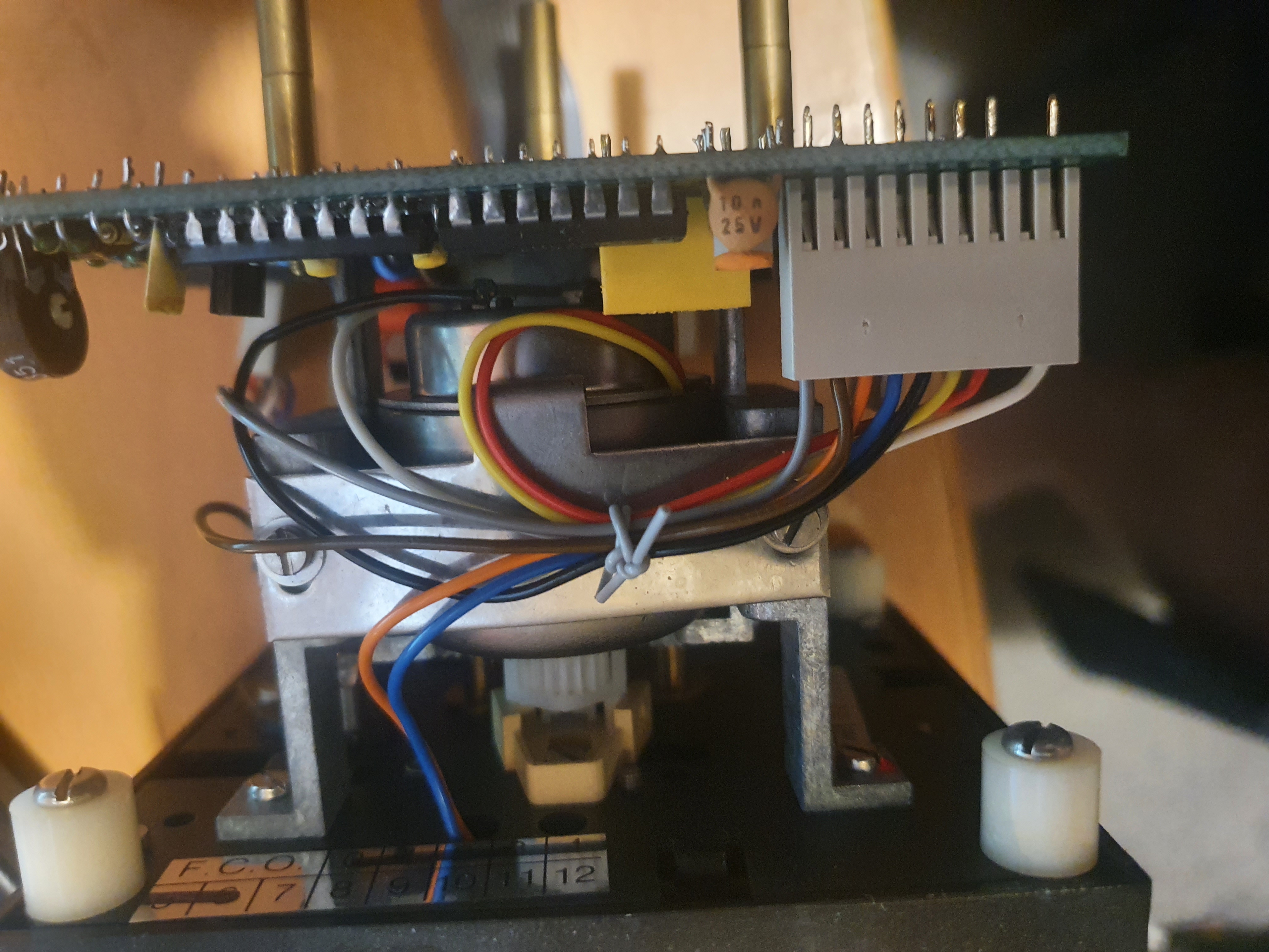

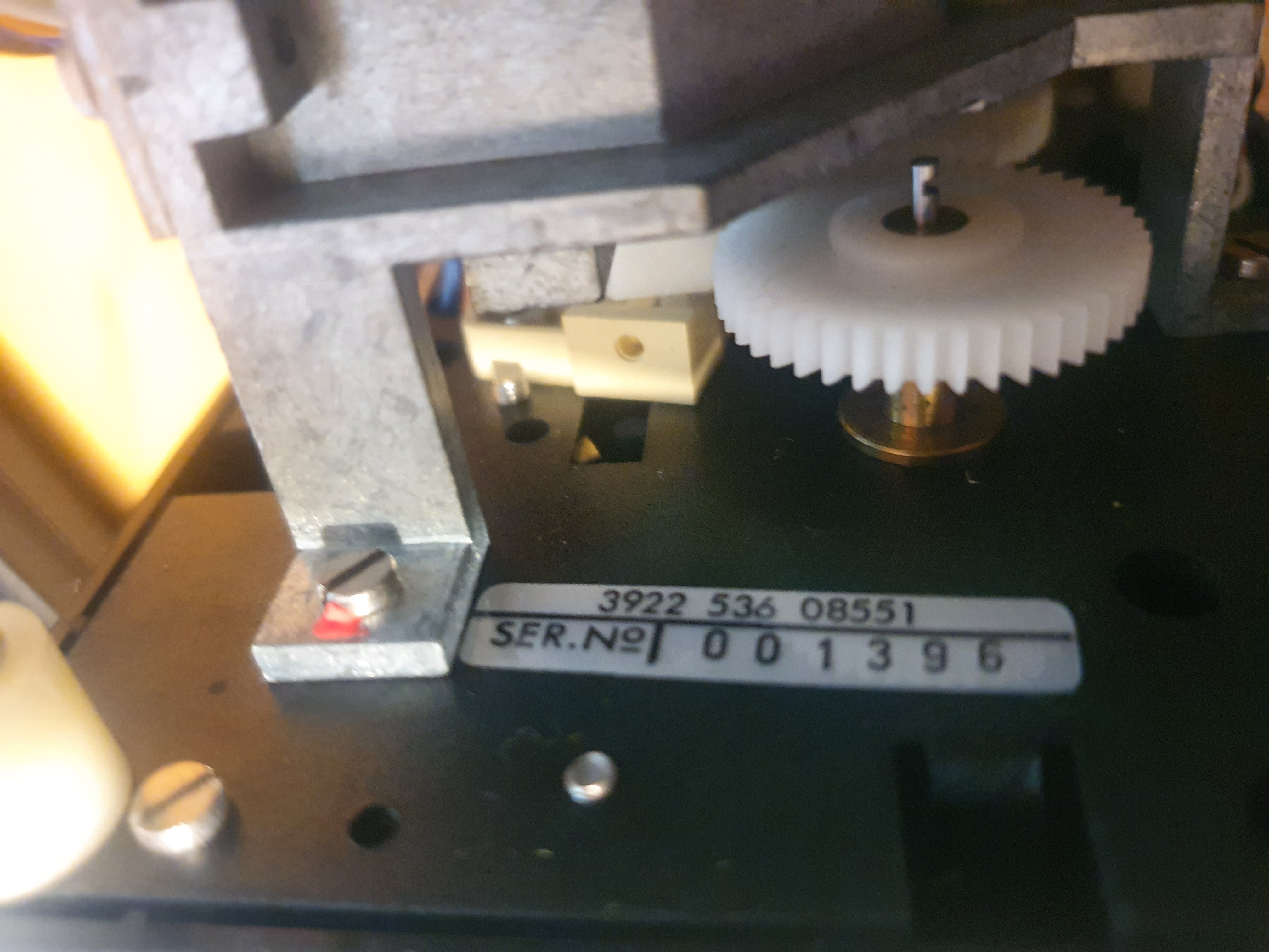

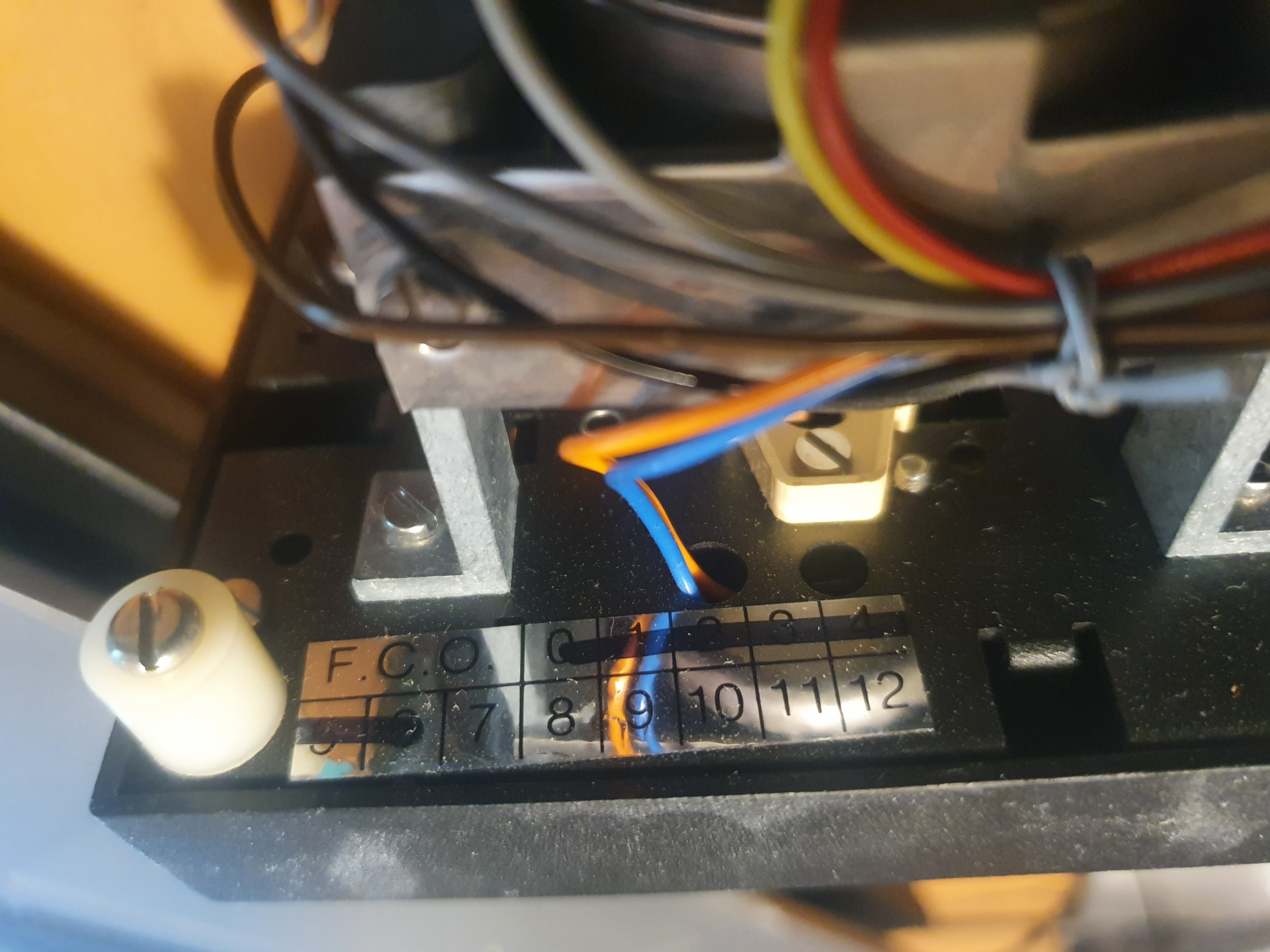

Here are some photos of the insides - only 2 labels that I can see so hopefully they can help you identify the drive model. I have some tapes for this and they are all 30min tapes if that helps.

admin wrote: Fri Oct 07, 2022 12:54 pm Here are some photos of the insides - only 2 labels that I can see so hopefully they can help you identify the drive model.
I'm surprised there's no obvious model number anywhere. Your photos look remarkably similar to one that I got from a Hobbit owner, especially the one with serial number and large cog. So maybe they are the same tape unit, difficult to say.
There's a technical manual for the MDCR at http://www.nascomhomepage.com/pdf/mdcr.pdf. On the last page is a layout of the circuit board, would you say this matches yours?
Re: Ikon Ultra Drive
Yes - connectors and ICs are all in the same place...so I suspect its the same drive......
