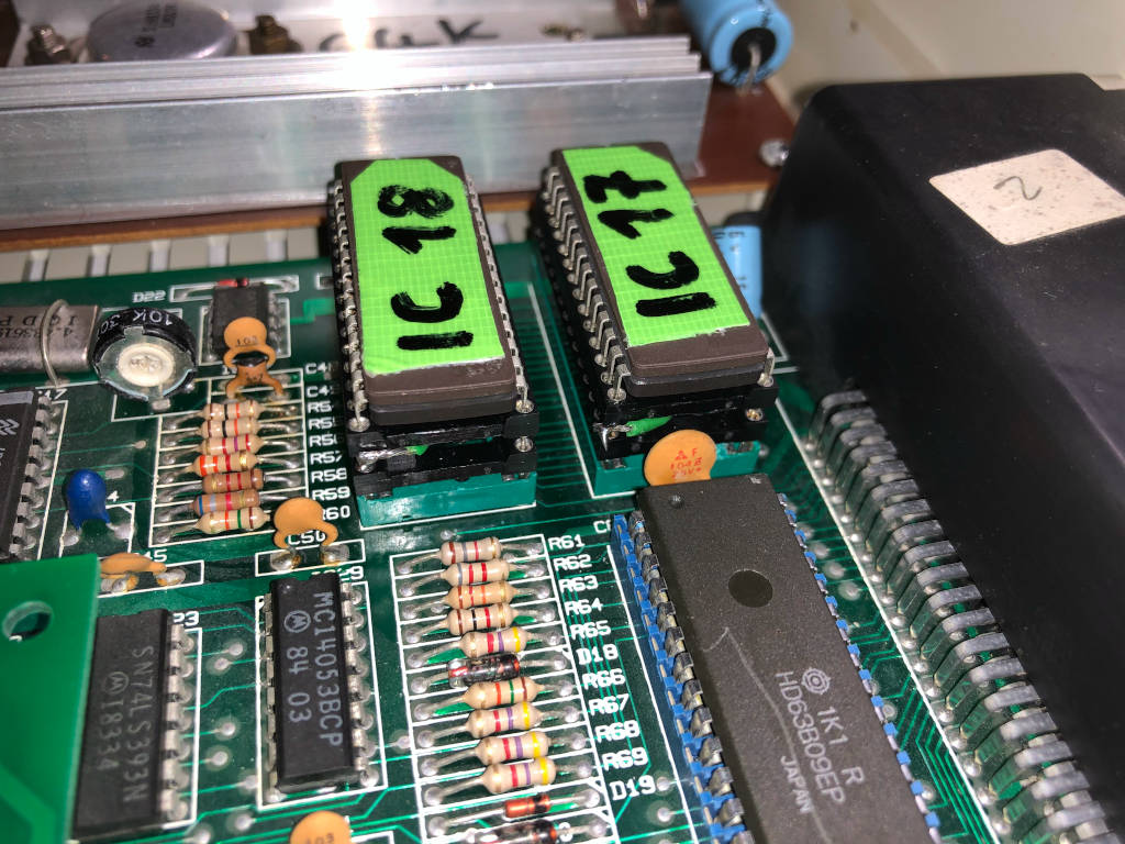

I asked a friend of mine at the CPCWiki, and he pointed out, that A14 must be tied to +5 or Ground for it to select the high memory addresses or the low ones.

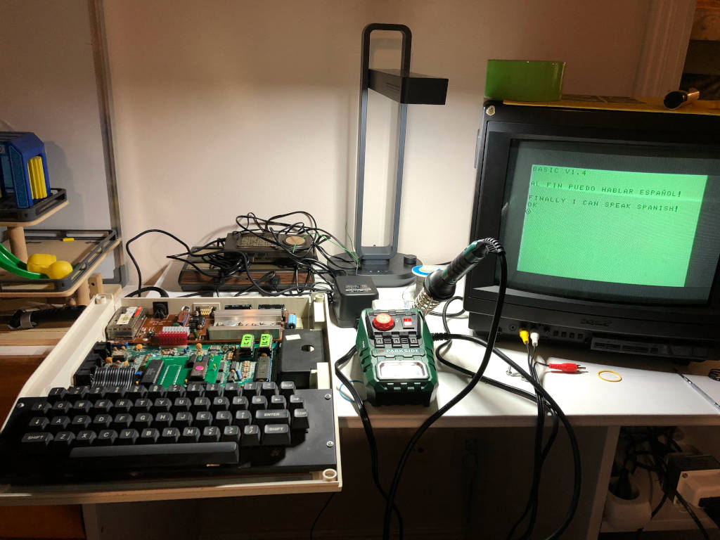

It turns out that connecting A14 to Ground makes them work and I now have successfully transformed my Dragon 200 into a 200E!
Oh, happy day!
I had to use two sockets sandwiched together, and solder a cable between A14 and ground.
Here are a couple of pictures for your viewing pleasure, and a big thank you for your kind help!
