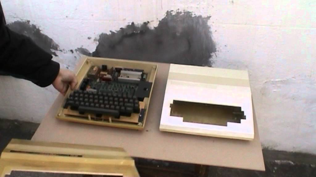

The link is to "perifractic's retro recipes" on youtube and shows a new theory of just placing yellowed plastic in the sun with nothing else added just some good old UV rays.
If this method works and it seems to, although slowly, then it should be far better and safer than using peroxide.

Guess that it was already know that retro brightening already worked using sun only since the recommendation to accelerate the process usually involves using UV-lights. And agree that using peroxide can be a bit risky if you go with for example with solution with 12 peroxide which is the highest concentrate allowed here in Sweden without permit. Going to local hairdresser and buying hair bleach is an alternative which I would go for as the peroxide in hair products usually is 3% (at least here in Sweden).
Also, to avoid this process to continue one would need to seal the surface with some kind of clear lacquer. But, to find something that wouldn't change the original finish I guess would be quite hard.
Looking at this extreme example of Dragon 32 and the result, I'm just thinking if this actually is the actually coloring of the computer or if it was overdone?
