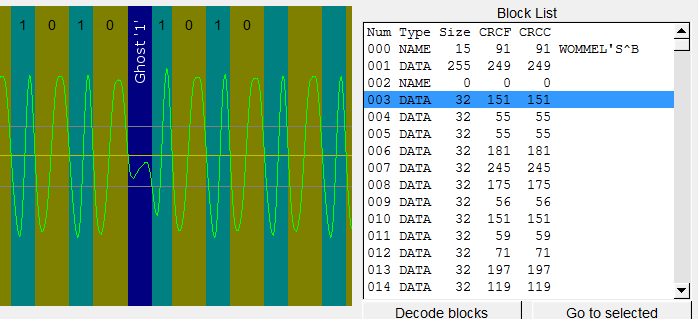

The pulses are consistent, every 32 byte block from the loading screen has the 'ghost bit'. It's recorded at a very low amplitude and slightly off-center.
I've attached an annotated picture of the ghost bit.

Hi Rob, that's a nice image you've created there. I'm thinking how great it would be if there was software that could automatically generate that kind of image and highlight the marginal bits for manual correction.
The ghost bit could just be a false waveform caused by a short gap between the two bits. The limited frequency response of the tape means that a bit cannot stop at the mid level and will overshoot before heading back. It looks like it's followed by a leader so it wouldn't have much effect.

The short gap is exactly the size of a full 1 waveform, maybe I could try to set it as a 0 waveform and see if it still loads. If not, it must be definitely a copy protection mechanism.
Today is your lucky day, then :D That is a screenshot of a tool I'm developing for fixing Dragon tapes, as I realized that no code could recognize the errors better than the human brain.
As soon as I have implemented a couple of features, I'd like to clean the code a bit and make it available to you guys. It uses the FLTK library and works flawlessly on Windows, OSX and Linux.

One thing I remember about Rommel's Revenge is the way the screen scrolls up while it is loading. I imagine it would require a long gap between blocks to give time for the scrolling (much longer than the 'ghost' bits). If a tape is recreated without the gaps it might not work.

I have seen this on some other tapes and am yet to be convinced its actual copy protection, it seems too advanced for the Dragon era in terms of tape duplication and detection within the loader code.
The extra low amplitude "bit" could just be an artifact of the duplication machine used to create the tape, or in some cases the machine being used to play the tape and actually has no meaning to the custom loader.
That would make sense as the game loads fine under XROAR and the only reason it doesn't work on a real dragon is due to the missing "gaps" that the CAS file format does not preserve.
The only copy protection I have seen to date is things like invalid CRCs or an EOF block in the middle of the code blocks - both these approaches would stop Tape to Tape and Tape to Disk programs (for a while) and indeed the did not convert to CAS with the original DC.EXE program unless you forced its RAW mode for the same reasons.
