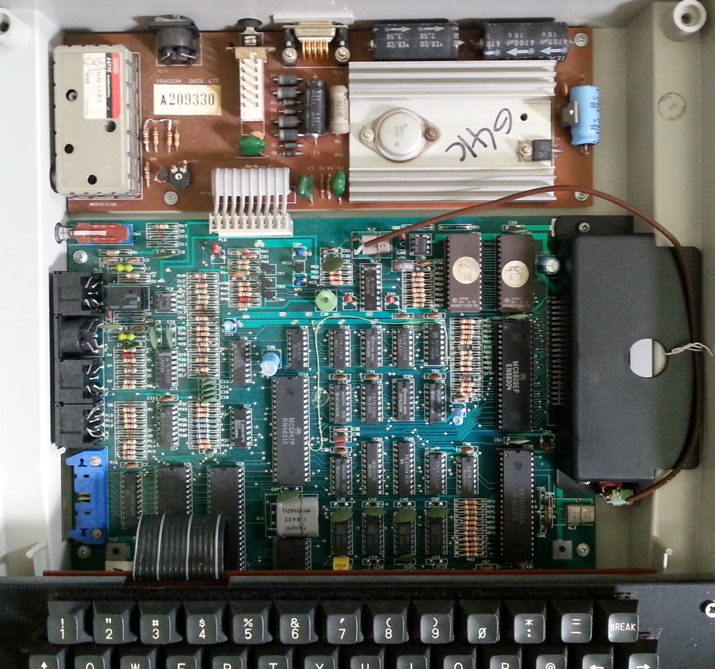

I have a Dragon 64 here, buyed on ebay... Now i see there is a mod.
There is a condenser connected parallel to the "quartz crystal" XL2. See picture on the right side.
What does it do? Change the frequency pulse?
What does this dragon mod do?

That looks like the mod that switches the display to monochrome for a sharper picture. 'Shorting' the crystal with a capacitor removes the colour sub carrier from the PAL signal.
That said, I've always had the impression that the D64 display was a lot cleaner than the D32. Maybe some still had an annoying amount of 'dot crawl'?

Yes you are right. I connected the dragon and test it. It switched to greyscale and it's clearer.
I didn't not see any significant difference between 32 and 64 screen output.
