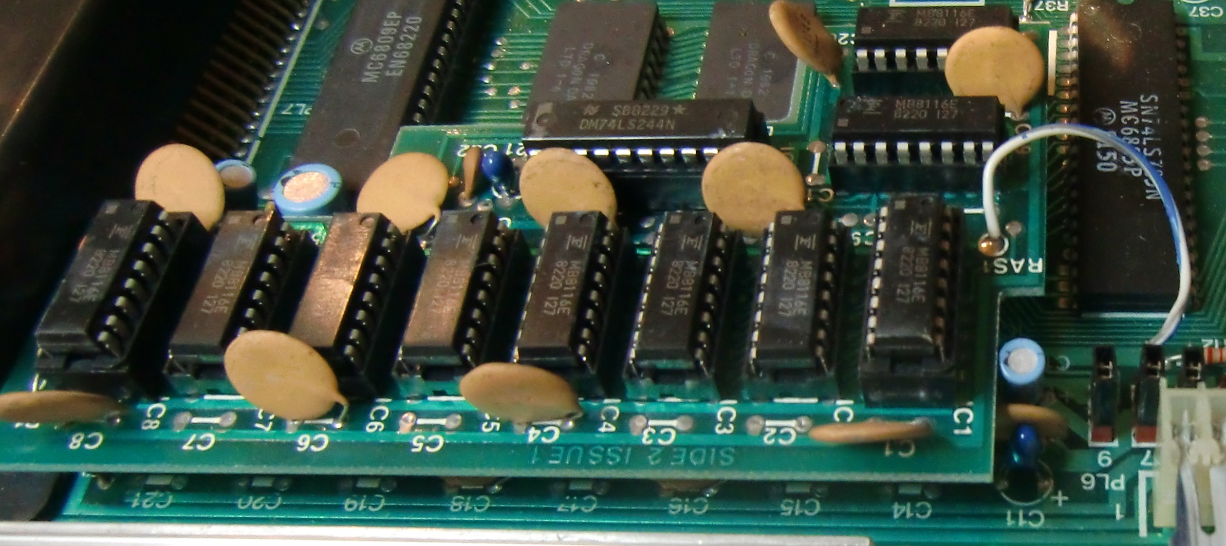

That was kind of a brutal job, to cut of the patchboard of my issue 2-PCB and to desolder all those chips and components, which do not like to give up easily. Most of them have ugly bent wires on the solder-side of the PCB and stick to the pads. But in the end, I managed to remove the chips without cutting of the wires. I'm pretty confident, that the 16k-DRAMs survived the procedure. The PCB did, the lines and pads did not come off immediately.
That's what it looked like:

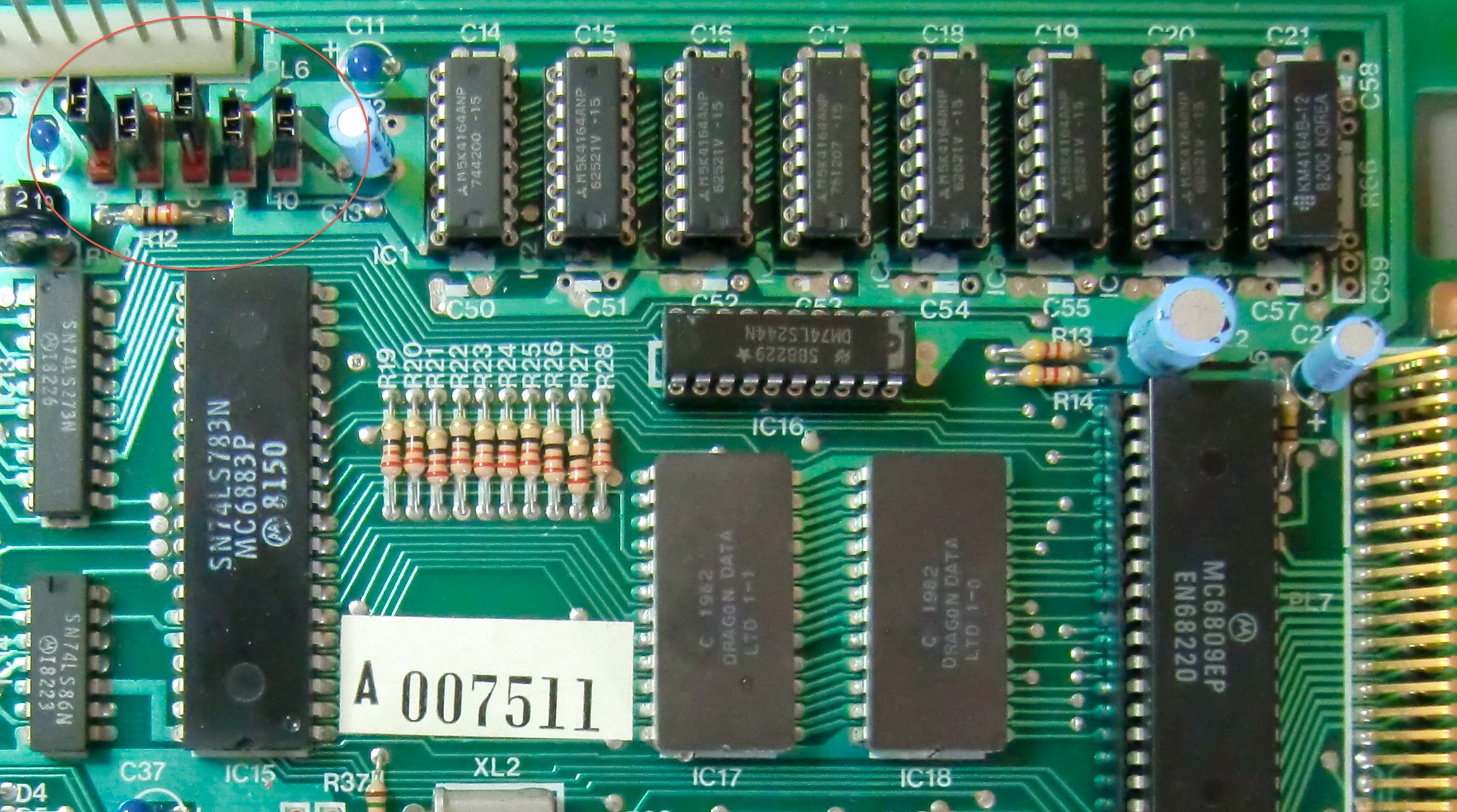

I decided not to use the patchboard any more, since I had to desolder the old DRAMs on the mainboard anyway - so way not use that space for the new chips? I ended up with:

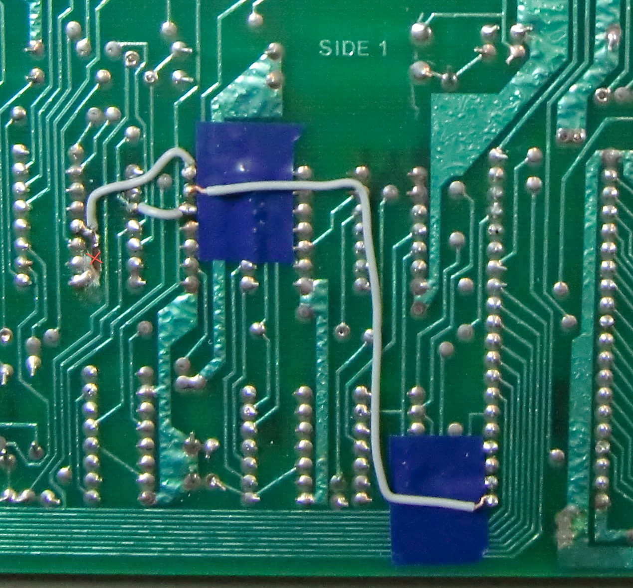

Final job: changing the decoder a little bit, adding a few wires and cutting one line (red cross):
Before testing, the voltage jumpers (red circle, picture 2) had to be adjusted. Since I was lazy an hoped that the setting "d) Set the jumpers to l,4,5,8,l0", as mentioned in the article, would be ok, I did so and immediately fried two of the eight new DRAMS. :o When I sensed the smell, it already was to late. The fast chips burnt first and saved the slow ones. I only had one spare chip (of course) and therefore had to order a few new 64k-DRAMS. Fortunately they are cheap and still easy to get (ebay, electronic component sellers). The suitable 64k-chips all use single voltage supplies (5 VDC)(data sheet!). No more 12 VDC or -5 VDC. The correct setting of the jumpers is 1,4,6,8,10!
