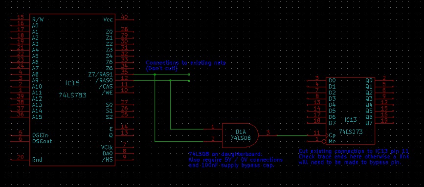

by sorchard
I've made a sketch of the proposed mod though be warned I haven't looked at the board to see how best to do this. There's a chance the RAS0 trace doesn't stop at IC13 pin 11 and will need cutting in two places and linking to bypass the pin.
The wires from the daughter board should be kept short and it might be wise to insert a 22R resistor between the gate output and IC13 to suppress ringing. (The SAM outputs to the DRAM array have series resistors for this purpose)
It might be worth trying to drive IC13 pin 11 from E instead to see if that works before building a daughterboard. This might violate the VDG setup time but I'm not sure having not studied the timing diagrams very closely. (In fact I haven't checked that the delay introduced by the AND gate doesn't push things too far though it would be surprising if this stopped it working)
This should only be done on a Dragon that 'needs' it. It will make a complete mess of the display on a 64K mode D32.
The disclaimer is I've never tried this and haven't heard of anyone else trying it either.
An alternative fix would be to upgrade the machine to 64K ;-)

This fix (independently designed) was tested a couple of years ago at the 40th year Dragon meet up in South Wales. It works great - and Phil Harvey-Smith has quite possibly since designed a SAM carrier board that implements the fix neatly...

Yep I'll attach the Eagle files Gerber files........
Please note you will need to break IC13, pin 11 from the circuitry on the D32 mainboard (either by cutting and bending the pin, or cutting a track on the mainboarrd).
