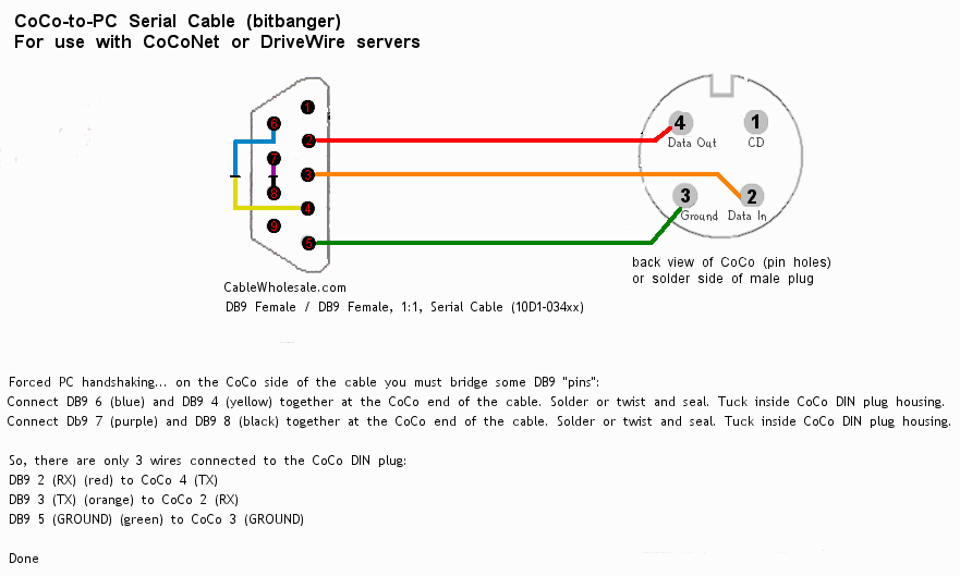

The diagram below (by Roger Taylor) shows the wiring for the CoCo-to-PC Serial Cable for use with CoCoNet and DriveWire servers. Are the links at pins 4-6 and 7-8 needed if using the cable only for the Drivewire 3/4 server?

These links are not required for the Drivewire cable.zephyr wrote: Are the links at pins 4-6 and 7-8 needed if using the cable only for the Drivewire 3/4 server?
For the Dragon the cable should be built according to the instructions in my tutorial here: viewtopic.php?f=5&t=781
For a Drivewire cable for the CoCo, see the attached instructions. Note that the description part which includes Vcc in the cable is incorrect, but the pinout table is correct.
There is also a modified version of the attached CoCo cable wiring in which pins 1 and 2 (CD and RxD) are tied together. This is necessary to achieve the 230 kbps bit rate on the CoCo3, but will also work (but not required) at the lower bit rates.
