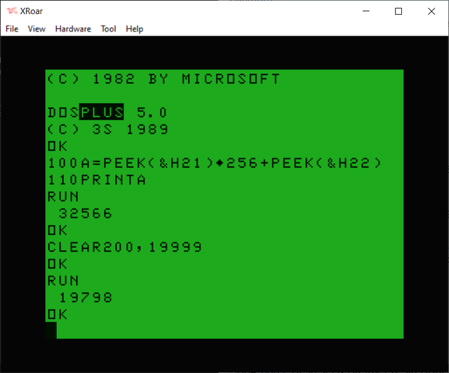

Back to my question on mixing assembly routines with basic, if I understand it correctly, CLEAR 200, 19999 (for example) would tell Basic that it has 200 bytes for string somewhere and that I'm free to load my binary data/routines from 20000 until 32767. Is that right?
Where does the stack live?

Yes. For the most part, you can sort of get away with CLEAR200,20000 but I think there's something to do with the operation of VAL() that can overwrite that extra byte. So stick with CLEAR200,19999.
The stack then begins below the allocated string space - seemingly minus another couple of bytes (which I would bet a pint is something to do with not bothering to adjust stack calculations between the 6800 and 6809 versions). So the first byte pushed to the stack will be at address 19999-200-2-1 (that last -1 allowing for the predecrement).
Note: actually the first byte written is one higher (19999-200-2), and is set to 0. Don't know why!

by pser1
Hi!
you are right, Robert
The stack would use from memory 19999-200 downwards, as shown in attached image
The graphics page(s), the Basic, variables and arrays will be able to use up to that 19798
but you should better make sure that the stack doesn't grow down enough to overwrite
your data (variables and arrays)
