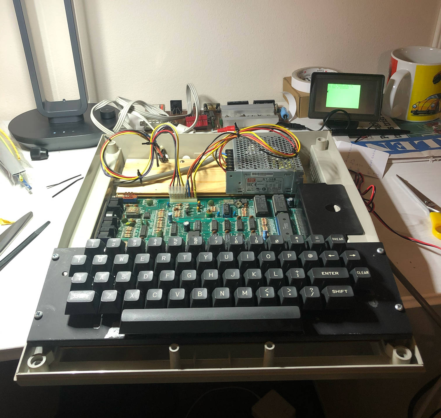

Posted: Sun Oct 25, 2020 11:24 pm
I realised that I could partly use an ATX psu connector, so I used that and managed to get it working! :D
I'm quite happy with the result as I don't depend anymore on an external transformers, and got a composite video cable integrated on the Dragon, so now it's really plug'n'play :mrgreen:
Plus, it's 100% reversible, no permanent modifications.
And now some pictures for your delight:
Thanks a lot for your suggestions!
