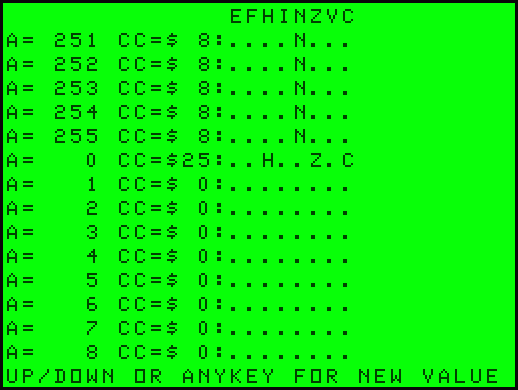

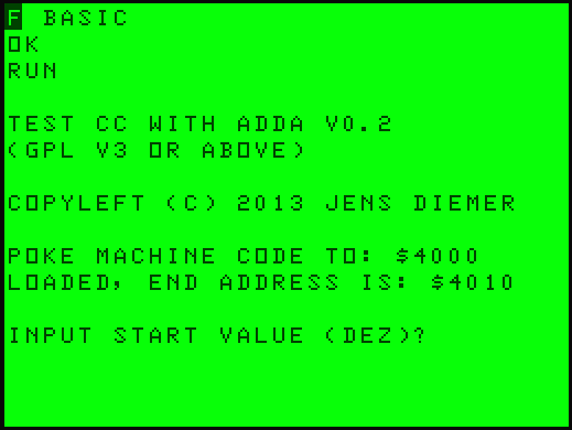

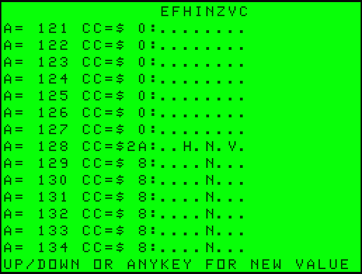

I Updated my testCC_ADDA.bas and these values are exactly the same with it in XRoar: https://github.com/jedie/PyDragon32/blo ... C_ADDA.bas
testCC_ADDA 02a.PNG (8.39 KiB) Viewed 5309 times
testCC_ADDA 02b.PNG (10.1 KiB) Viewed 5309 times
testCC_ADDA 02c.PNG (10.37 KiB) Viewed 5309 times
Now i would like to so the same with SUBA, INCA and DECA...
ADDA and INCA should set the same CC values, except H and C, isn't it?
