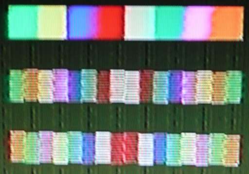

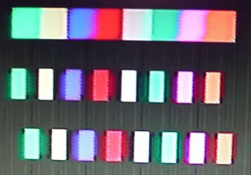

well, finally I could test the mixing of two SG24 images.
The firsl row is made of bytes with the 8 bits of same color in both images. These show still and normal.
Second and third rows are the result of mixing a byte that has left bits colored and right ones in black in one image
being the other image the contrary, left bits are black and right ones colored with another color different from the one in the other screen (C2 = 9-C1)
So we are focusing on blocks of 1 byte wide and 12 bytes high (what an ASCII character would occupy in this mode)
The result is painfull, worsed by the fact that the image is a small part of the screen and the photos I have taken are horrible, but the actual image on the Dragon screen
is not much beter than shown ... pity!

Yes, a pity the SG24 doesn't work so well, though it could be the monitor. Is it a CRT? The display can be distorted by bright areas so the two frames don't line up properly.

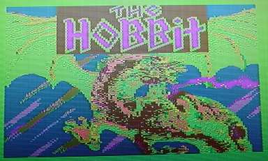

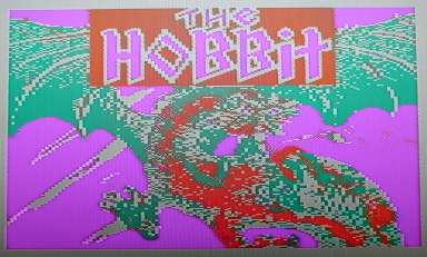

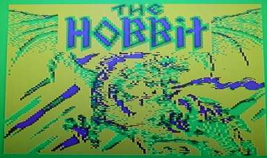

I have to say in defense of the result that this is the first approach I have made with a little Java apllication that simply substitutes each color in the BMP with a combination taken from a table and there is no 'intelligence' to try to get the best combination that will give a result as approximate as possible to the original, so the colors you see here, are not the same in the original :(
The photos don't suffer the bit move because they are just one flash. I attach them here
PMODE3:SCREEN1,0
PMODE3:SCREEN1,0
PMODE3:SCREEN1,1
PMODE3:SCREEN1,1
Superimposed Image
Superimposed Image
