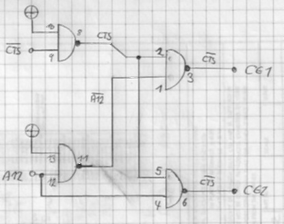

I made a little drawing of the 7400, just for me to make it easier to see, what's going on. I know, those symbols are old, but I always liked them better (an it's an old computer ;) .
!CTS A12 | CE1 CE2
  0   0  |  0   1
  0   1  |  1   0
  1   0  |  1   1
  1   1  |  1   1
(CTS = Cartridge Select Signal)

Cool. I like the old symbols - but can never remember them. I'm not too hot with the the newer ones either mind. :)
Just noticed a mistake in my note about the chip selection:
Low on A12 creates a low on CE1 and a high on CE2
I should amend the graphic really... but I think most people will realise the typo.
