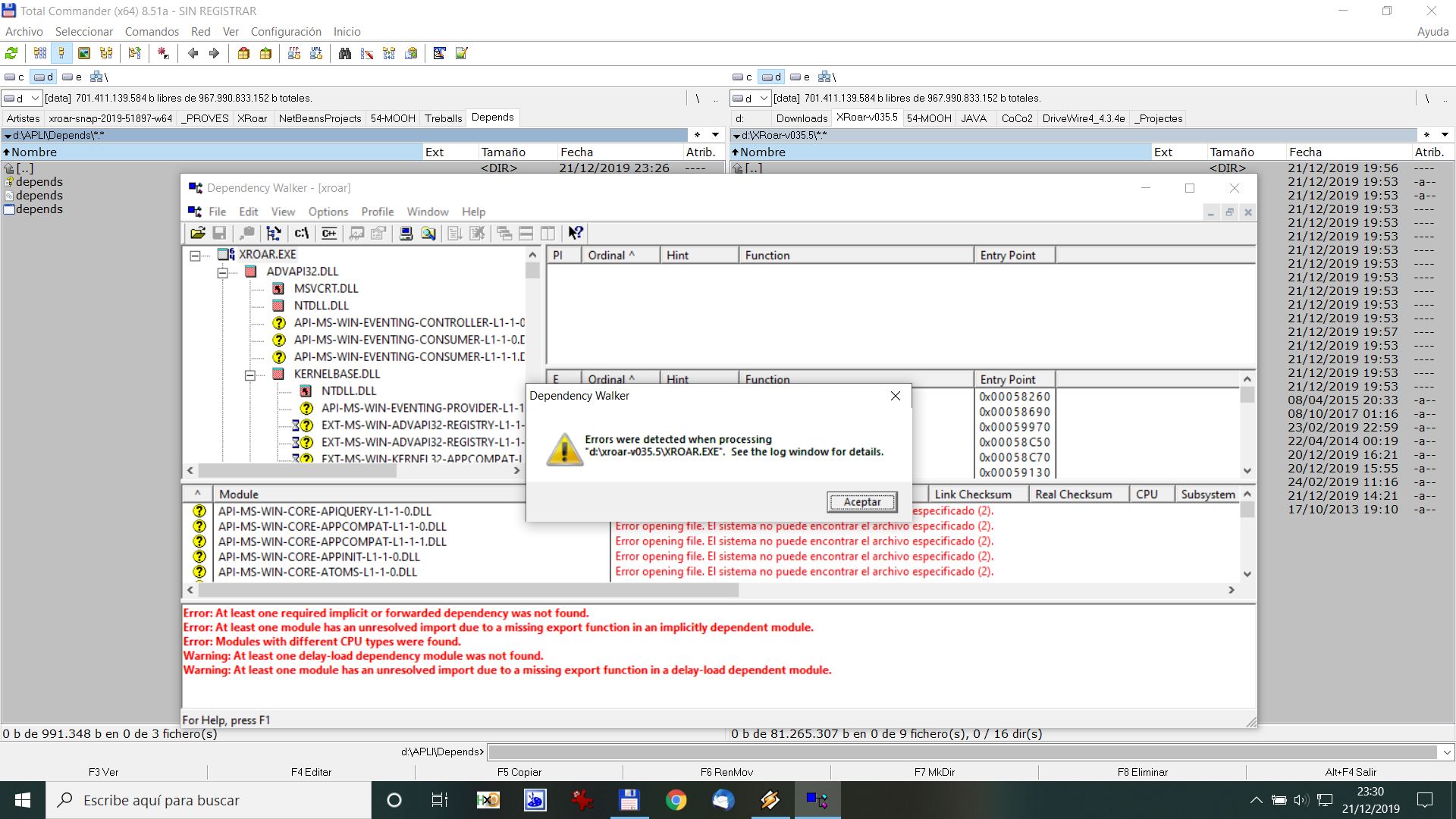

I have downloaded depends.exe but it seesm to be usefull for a lot of windows versions up to Win7-Win8, not for Win10
Anyway I have excuted it on the new failing snapshot and on the old working one.
These are the results. Almost same errors :-(
Result for working old snapshot.jpg (295.16 KiB) Viewed 25721 times
Result for Last Snapshot.jpg (295.29 KiB) Viewed 25721 times

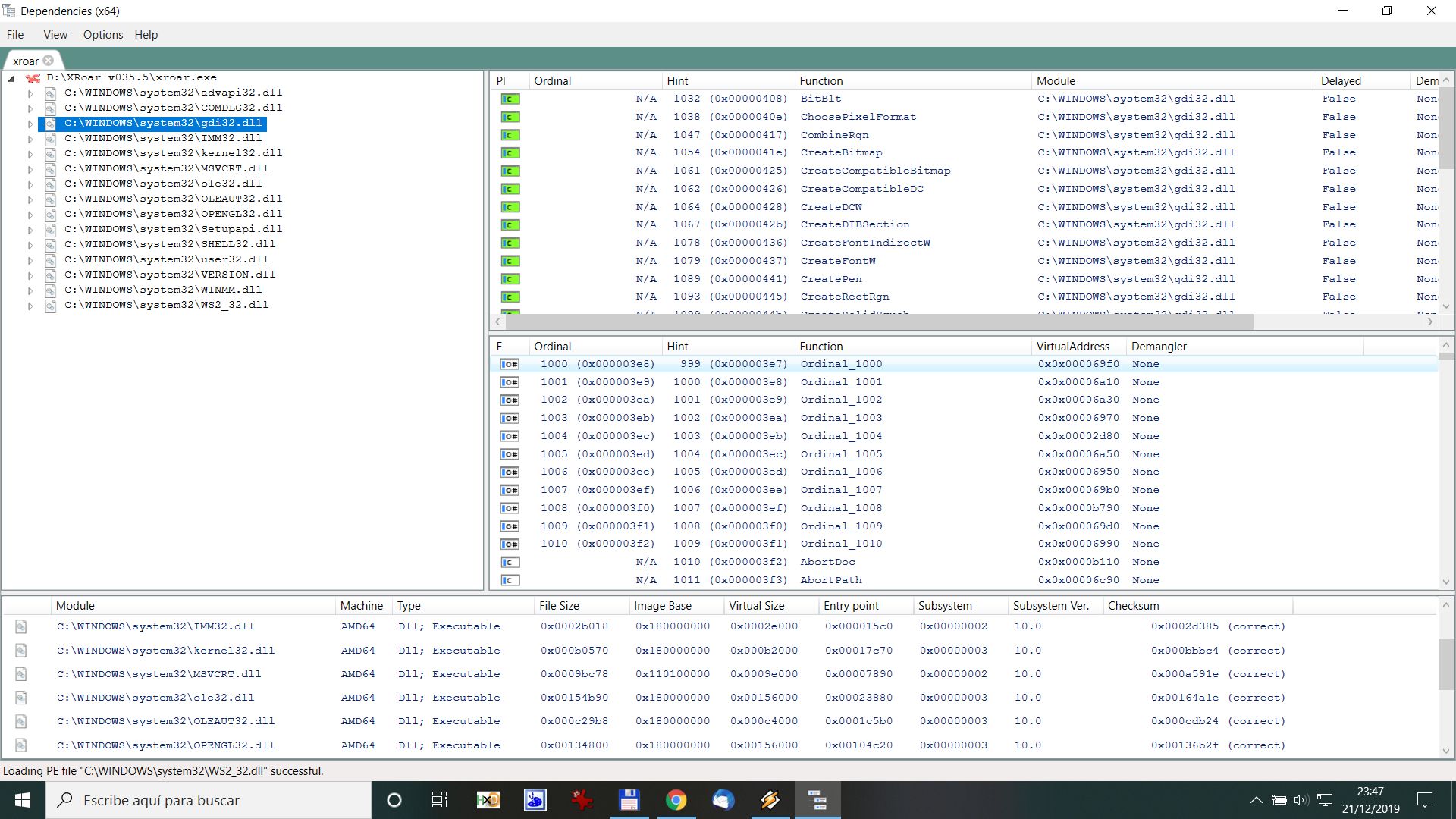

Searching the web I have found, recommended by MSN this url:
https://github.com/lucasg/Dependencies
And using this program on the new failing snapshot shows no problems :-(
