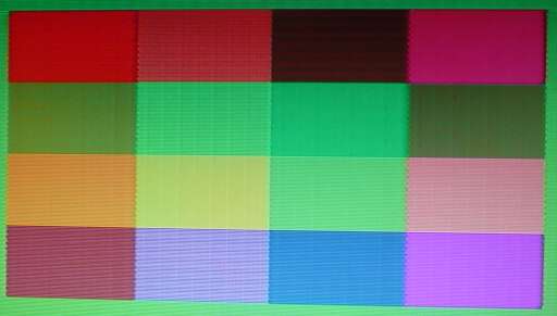

This is the result of mixing colorset1 and colorset2. On the Dragon screen, the colors are darker, the photo doesn't do justice to the result screen.
So we get 16 colors at the same time, and they are 16 different colors on the real thing.

I like the mixed colour sets even more. It should be possible to make some nice looking landscape images with those colours.
As you say, there's some work to convert images for display. I suppose something like photoshop could be used to do a colour depth reduction to the new palette.
