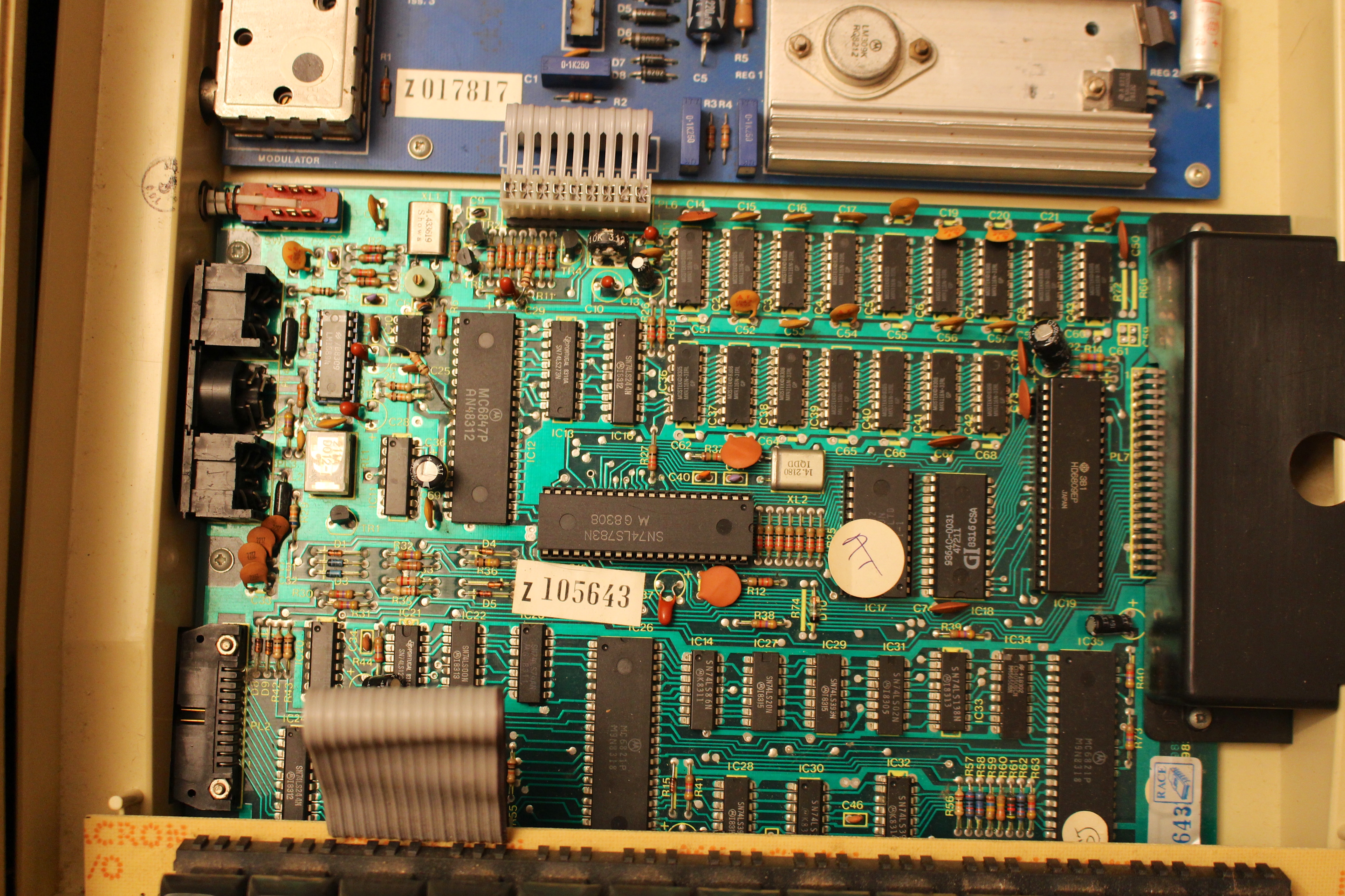

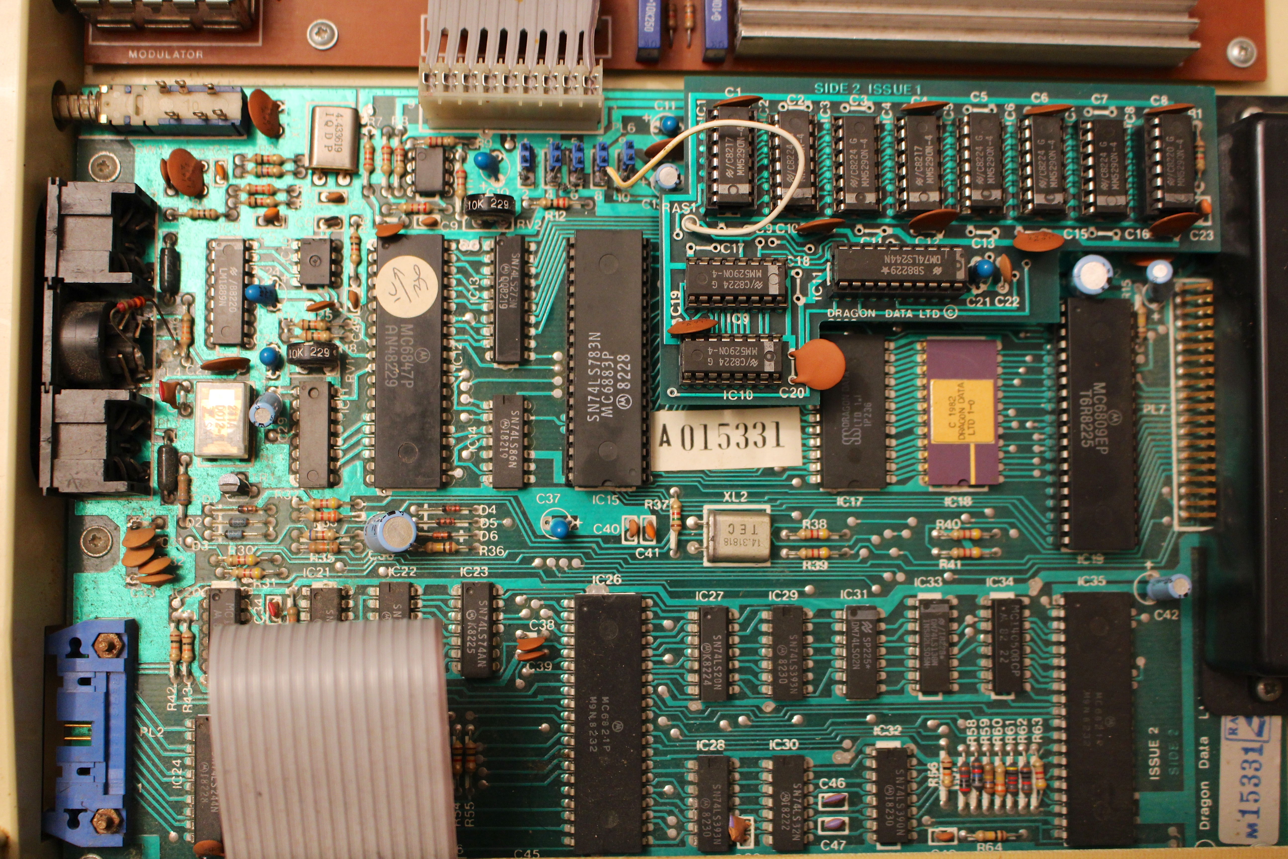

starfrog
Posts: 14
Joined: Wed Dec 11, 2013 3:08 am
Re: dragon 32 not displaying anything on screen
Post by starfrog »
dragon image 2
dragon image 2
dragon image 1
dragon image 1
hopefully this lets you see what I'm working with but there doenst appear to be any obvious issues ?
Based in Scotland
jltursan
Posts: 15
Joined: Thu Jun 06, 2013 7:04 pm
Post by jltursan »
RV2 (the 10K vertical black variable resistor) in the upper center of the second pic looks like it has some crystalization or dirt over it. If so, deeply clean it using isopropyl and a cotton swab.
I've found several times that it's covered by that "salt" and always has been responsible of weird boot faults: screen garbage, empty green screen ,etc.
