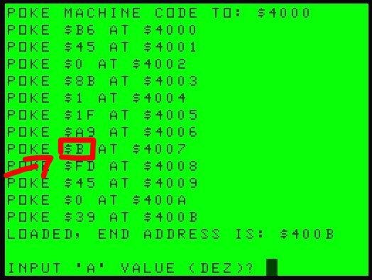

But gets strange behaviour in XRoar.

EDIT: It the 1030 DATA 1F,A9 ' TFR CC,B what brings XRoar into trouble. Maybe a but or my DATA code wrong?
OK, no i used the xroar trace to see what's happens:
4000| b64500      LDA     $4500               cc=a4 a=00 b=00 dp=00 x=4000 y=8497 u=0000 s=7f21
4003| 8b01        ADDA    #$01                cc=80 a=01 b=00 dp=00 x=4000 y=8497 u=0000 s=7f21
4005| 1fa9        TFR     CC,B                cc=80 a=01 b=80 dp=00 x=4000 y=8497 u=0000 s=7f21
4007| 0bfd        DEC*    <$fd                cc=88 a=01 b=80 dp=00 x=4000 y=8497 u=0000 s=7f21
4009| 45          LSRA*                       cc=85 a=00 b=80 dp=00 x=4000 y=8497 u=0000 s=7f21
400a| 0039        NEG     <$39                cc=89 a=00 b=80 dp=00 x=4000 y=8497 u=0000 s=7f21
400c| 0000        NEG     <$00                cc=89 a=00 b=80 dp=00 x=4000 y=8497 u=0000 s=7f21
400e| 0000        NEG     <$00                cc=81 a=00 b=80 dp=00 x=4000 y=8497 u=0000 s=7f21
4010| ffffff      STU     $ffff               cc=85 a=00 b=80 dp=00 x=4000 y=8497 u=0000 s=7f21
4013| ff0000      STU     $0000               cc=85 a=00 b=80 dp=00 x=4000 y=8497 u=0000 s=7f21
4016| 0000        NEG     <$00                cc=84 a=00 b=80 dp=00 x=4000 y=8497 u=0000 s=7f21
4018| ffffff      STU     $ffff               cc=84 a=00 b=80 dp=00 x=4000 y=8497 u=0000 s=7f21
401b| ff0000      STU     $0000               cc=84 a=00 b=80 dp=00 x=4000 y=8497 u=0000 s=7f21
401e| 0000        NEG     <$00                cc=84 a=00 b=80 dp=00 x=4000 y=8497 u=0000 s=7f21
4020| ffffff      STU     $ffff               cc=84 a=00 b=80 dp=00 x=4000 y=8497 u=0000 s=7f21
4023| ff0000      STU     $0000               cc=84 a=00 b=80 dp=00 x=4000 y=8497 u=0000 s=7f21
4026| 0000        NEG     <$00                cc=84 a=00 b=80 dp=00 x=4000 y=8497 u=0000 s=7f21
4028| ffffff      STU     $ffff               cc=84 a=00 b=80 dp=00 x=4000 y=8497 u=0000 s=7f21
The TFR CC,B is ok and seems to work. But after this it should come f75001 STB $5001 and not 0bfd DEC* <$fd
The last STU, STU, NEG is a never ending loop.
It's a inserted 0b that's brings everything out of sync:
I added a test output in the machine loader part:
65 V=VAL("&H"+HB$)
70 POKE PA,V	                ' POKE VALUE INTO MEMORY
75 PRINT "POKE $";HEX$(V);" AT $";HEX$(PA)
80 PA = PA + 1			' INCREMENT POKE ADDRESS
And yes, i see this line: POKE $B AT $4007 :shock: Why???
The complete .bas:

Posts: 665
Re: Howto try small machine code programs in BASIC ?
Oh!!!
It's this:
1040 DATA FD,45,00 ' STD $4500 ; STORE A+B
:o
Comments not striped in DATA ??? Boring :x
jedie wrote:Oh!!!
It's this:
:o
The only way to add comments is to add an extra REM line after each data line.

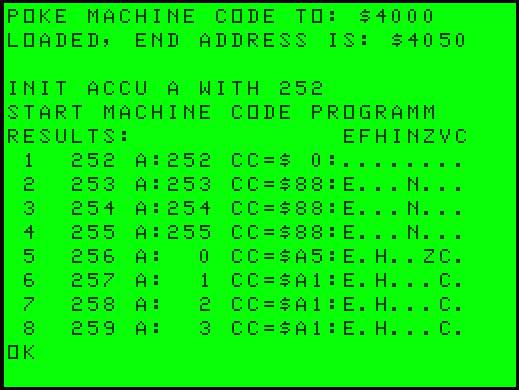

I rework on a older test with ADDA:

I expected that the carry only set after wrap around from 0xff to 0x0
EDIT: I recreate the XRoar trace for this:
