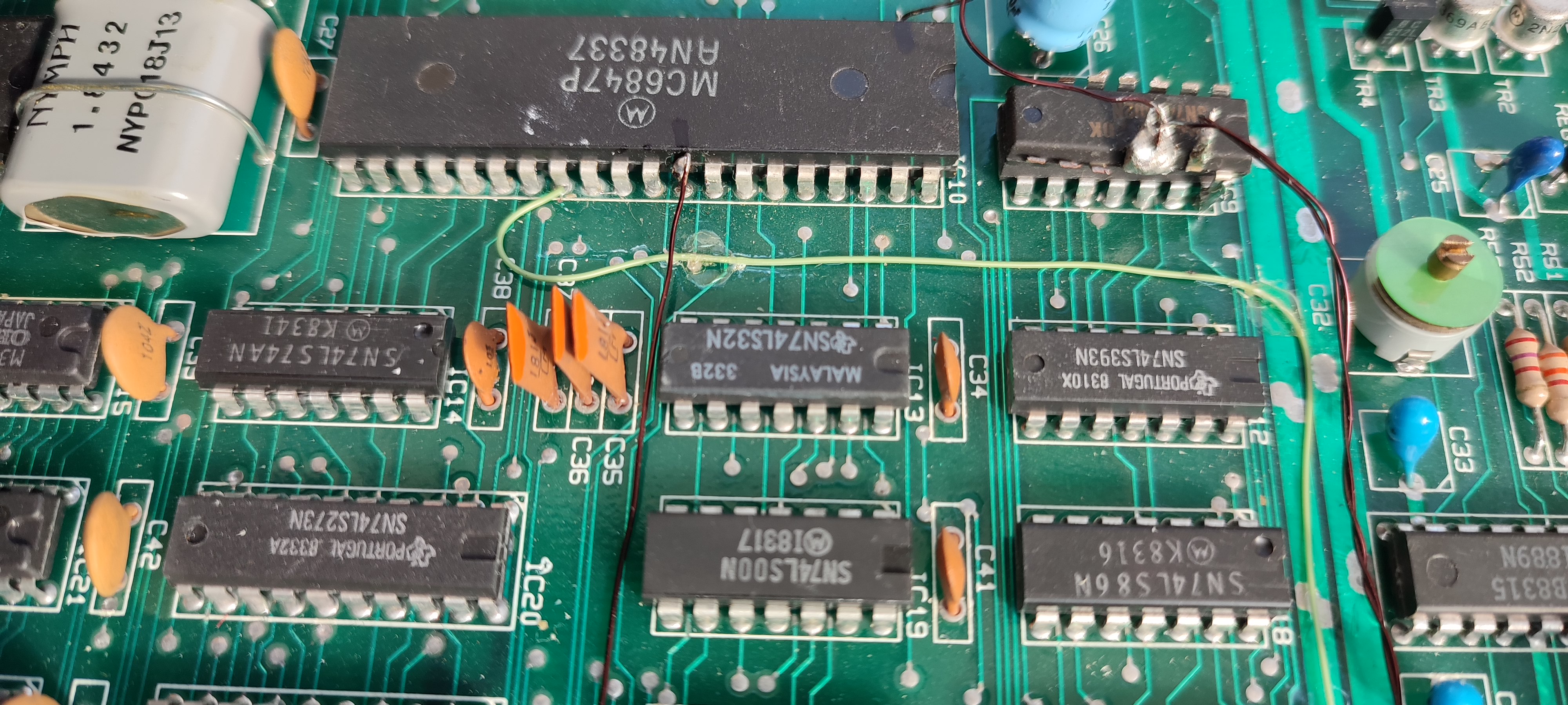

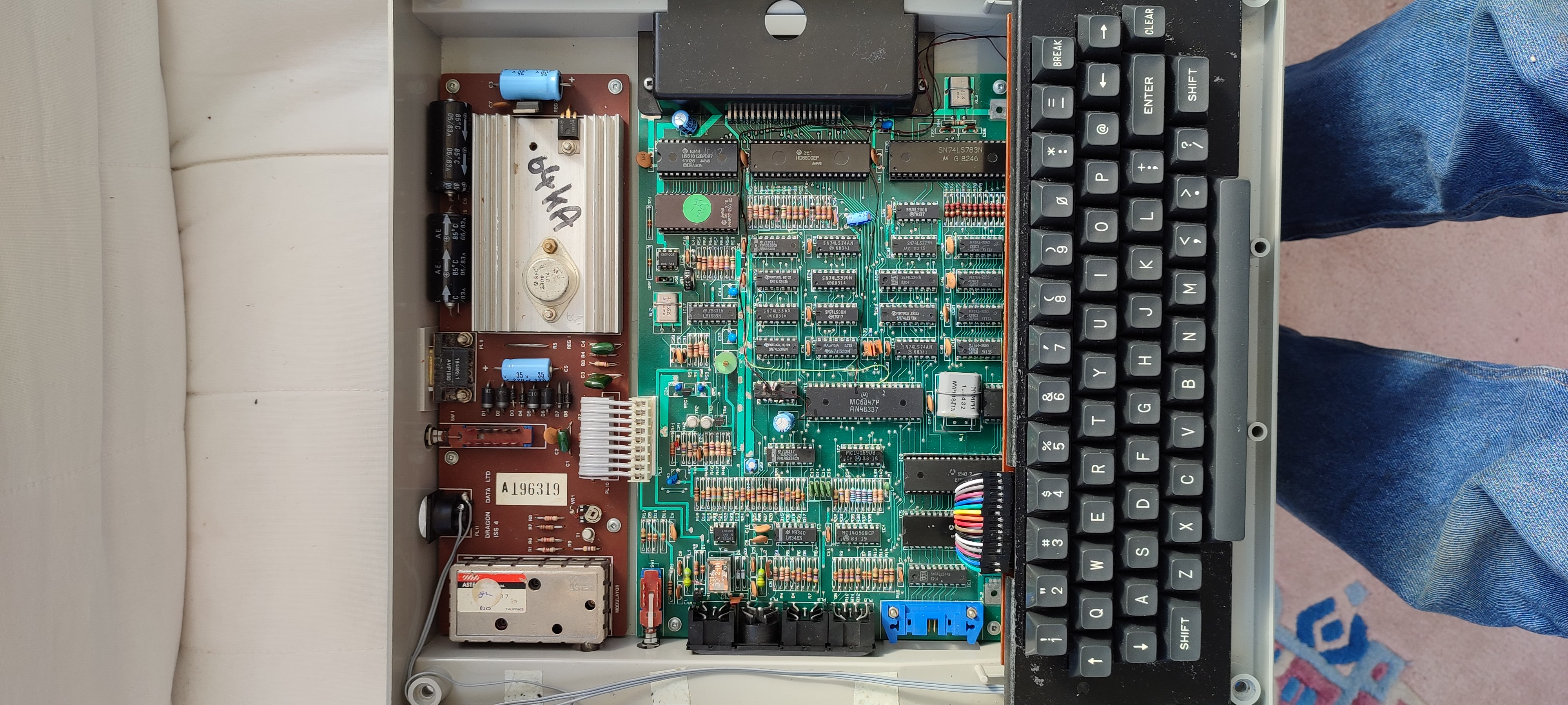

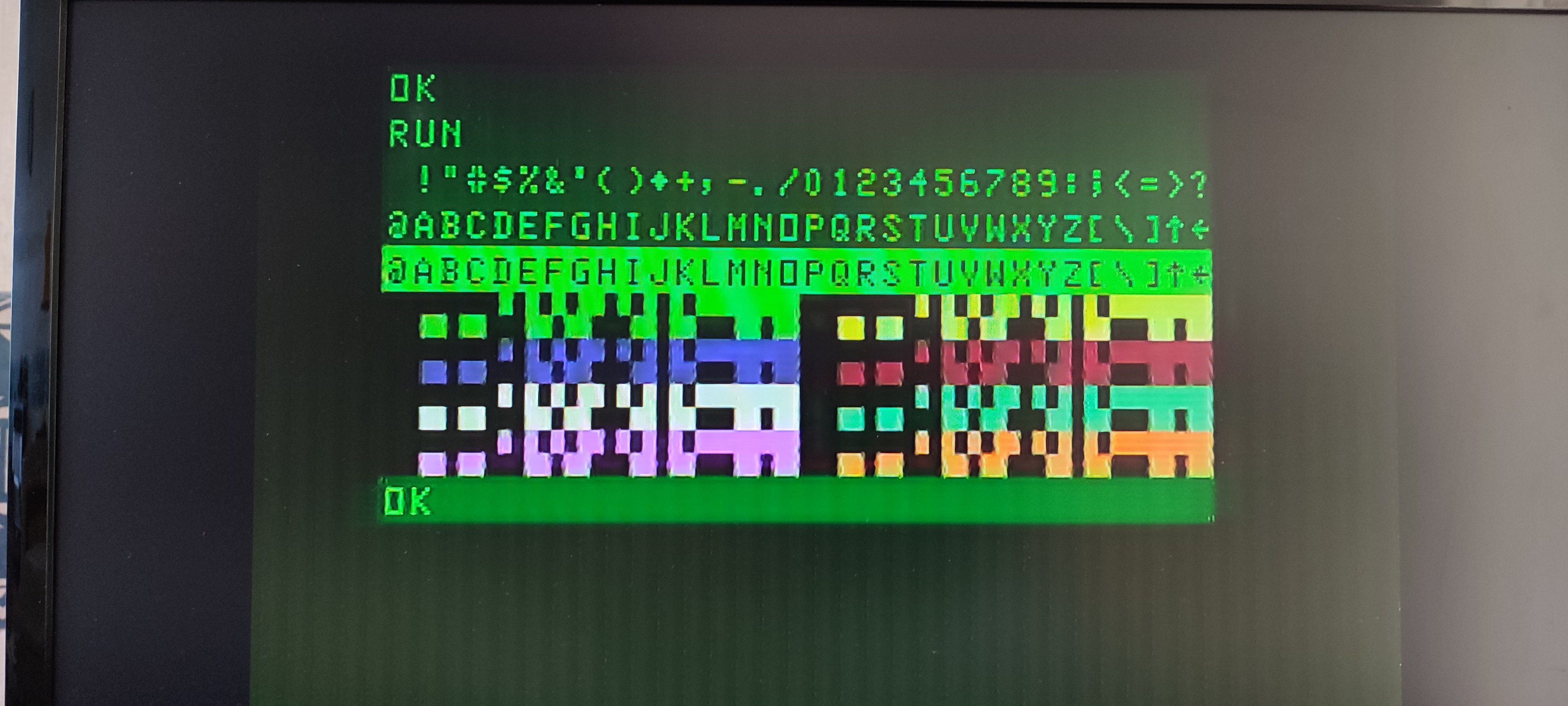

As the person who posted the original, let me explain - and add some pictures perhaps
The mod simply uses an LS chip wired to act as a NOT gate to invert the text video output.
Any NOT gate will do - and you may find a spare one somewhere on the board.
But it is very easy to do a piggyback as only 2 pins are soldered to the chip below
1. This mod will only invert the text characters on the normal 32x16 screen. It does not affect the semigraphics characters.
2. It will NOT invert any text that uses the graphics PMODE pages. So the OS-9 Go51 text will still be unaffected, sorry.
3. It will invert the black on orange as well as the black on green text display.
4. It is completely safe - you can flick the switch back and forth without switching off or resetting the computer.
I've just taken the lid off two of my Dragon 64s to take the pictures. One is series 3 with the mod hiding under the Dragon Plus board. The naked one is a series 2A and both work perfectly
