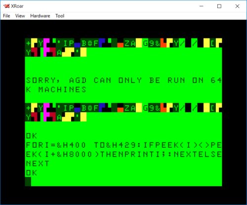

I tested your idea ... and this is the result:
The code used is this one:
			org   $3300
			put   $3300
			orcc  #$50							; disable interrupts
			sta	$ffdf							; switch to MAP1
			ldu   #$8400						; point to this ROM area
			ldx	#ErrMsg						; point to error message
			bsr	ShowMsg
			sta	$ffde
			ldu   #$0480						; point to this SCREEN area
			bsr	ShowMsg
			andcc	#$af							; enable interrupts
			rts									; return
ShowMsg	lda	,x+							; get a byte
			beq	EndShow						; end flag? exit
			ora	#64							; avoid inverted cars
			sta	,u+							; put on screen
			bra	ShowMsg						; go for next char
EndShow	rts									; return
ErrMsg	fcc	/SORRY, AGD CAN ONLY BE RUN /
			fcn   /ON 64K MACHINES/
EndPgm	equ	*
So it seems that the first loop makes a special effect, every byte from the ROM seems to be copied into
the corresponding screen byte.
You can see that the first two blocks have been POKEd by the program, the second already in MAP0
Finally the third block is created in Basic by POKing to screen the contents of the ROM from $8400 onwards
Well, now it is just a matter of discovering what the real hardware will do ...
Re: XRoar and Dragon32 emulation?
HI Ciaran,
I forgot to say that this last test is a clear demonstration that the write commands don't get their goal,
instead the lower RAM is modified copying there the pre-existing value from the pointed byte of ROM.
But then, when the program 'reads' the ROM still in MAP1, the data it receives is not the one from ROM
(already copied to RAM) but the one I had tried to POKE ... But that seems strange, so compares to equal!
Shouldn't I get back the ROM value instead? from RAM of course but the ROM contents.
This is going to end with a terrible headache ;-)
