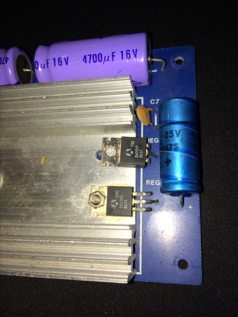

Converting from Issue 3 to Issue 4 could be as simple as swapping the 7905 reg for a 7912, if you don't mind losing the TV output. An issue 3 schematic would be useful to confirm this. There is some video level shift circuitry on the issue 4 that seems to be absent on the issue 3.

Would that be REG3 (the top one) on my blue Iss3 board?

Yes, that's the one. If you decide to have a go at this then you may wish to check the value of R2 which is a load resistor for REG3. It's 10K on an issue 4, but I can't see what it is in the issue 3 photo.
Resist the temptation to attach REG3 to the heatsink. The metal tab has a different voltage to the other components and things will be very unhappy without an insulating kit.
It would be wise to do a final check of the voltages on the connector before attaching to the D64 main board, and remember to mark the board as modified otherwise it might end up in a D32 in future and damage it.

Thanks for mentioning not to attach REG3 to the heatsink. I was almost tempted to do that. :oops:
How do I check the value of REG2?
Posts: 541
Re: Dragon 64 with a couple of issues
I could have been a bit more clear: I was worried about R2 the resistor, not REG2 the regulator. R2 is located above the ribbon cable. It's 10K (brown-black-orange) on the issue 4 board.
I've just noticed R2 is clearly visible in the other issue 3 photo and is 10K there too, so no problem.
I'm a little worried that I might be leading you along a path towards disaster so I feel that I should give you a friendly warning... Only attempt this if you understand what the modification is doing and you are confident doing it. If something goes wrong then it could damage your D64. For example if you get a short between input and output on REG3 then this will send a high voltage to the rest of the system. Also, as you've discovered, these boards are not the highest quality and it is very easy to delaminate the copper tracks if you don't have a temperature controlled soldering iron.
