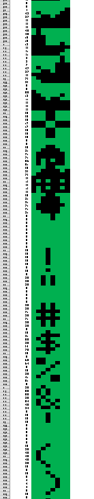

I've put the data section into a character editor spreadsheet that I'd used for the D200E charset. Am attaching a screenshot which shows the house sprite as mentioned in the manual, along with the spreadsheet itself.
The entire character set is there, along with what looks like some trekkie stuff, planes, tanks, subs, battleships etc.
