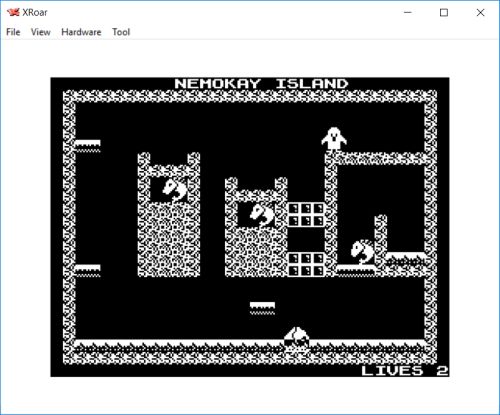

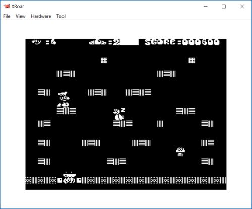

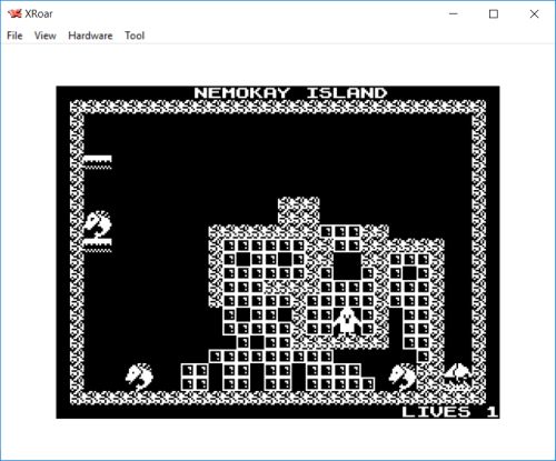

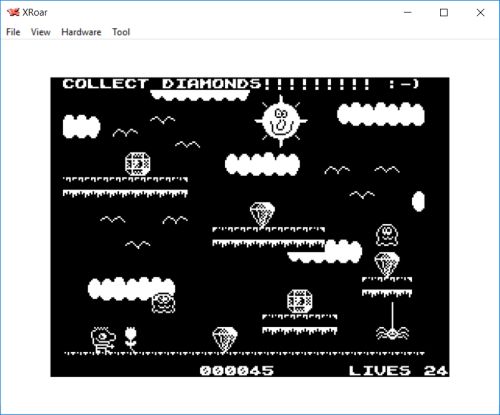

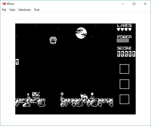

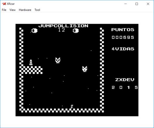

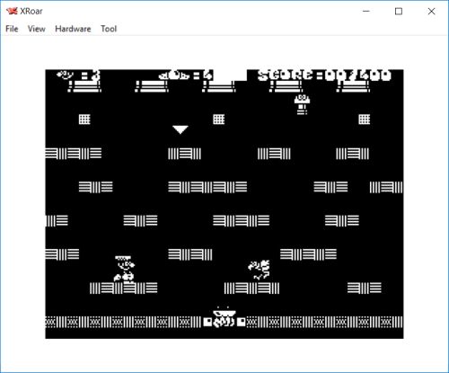

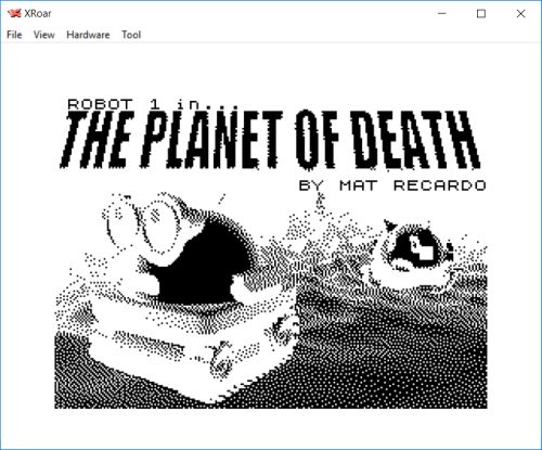

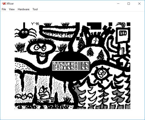

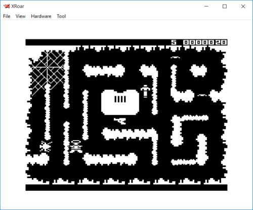

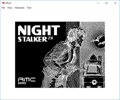

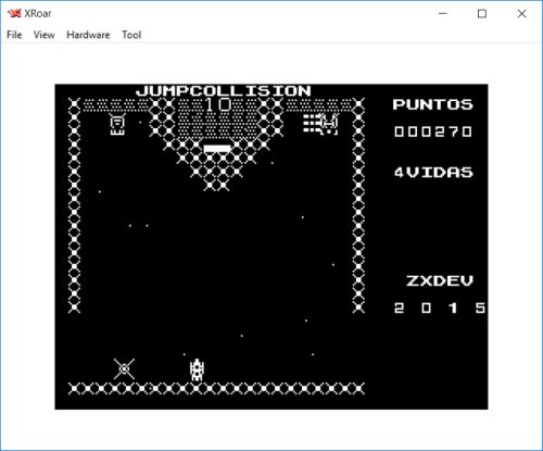

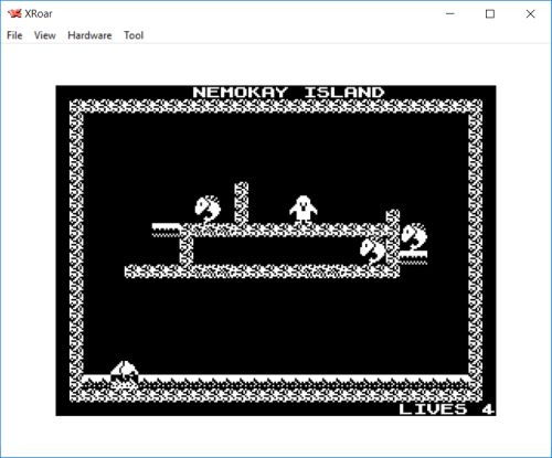

some screenshots of these games
Posts: 1851
Re: AGD converted games: Pack #19

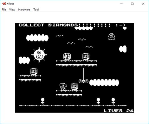

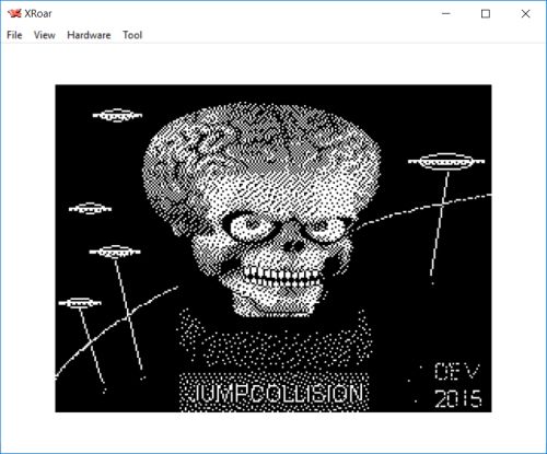

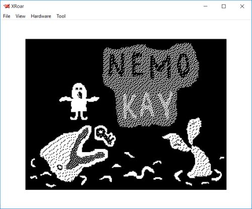

and yet some more

Planet of Death seems quite interesting... but I'm having trouble managing the inventory. I pick things up and it seem to cycle random stuff through it. It's definitely not the behaviour I see in a youtube video of the speccy version!
