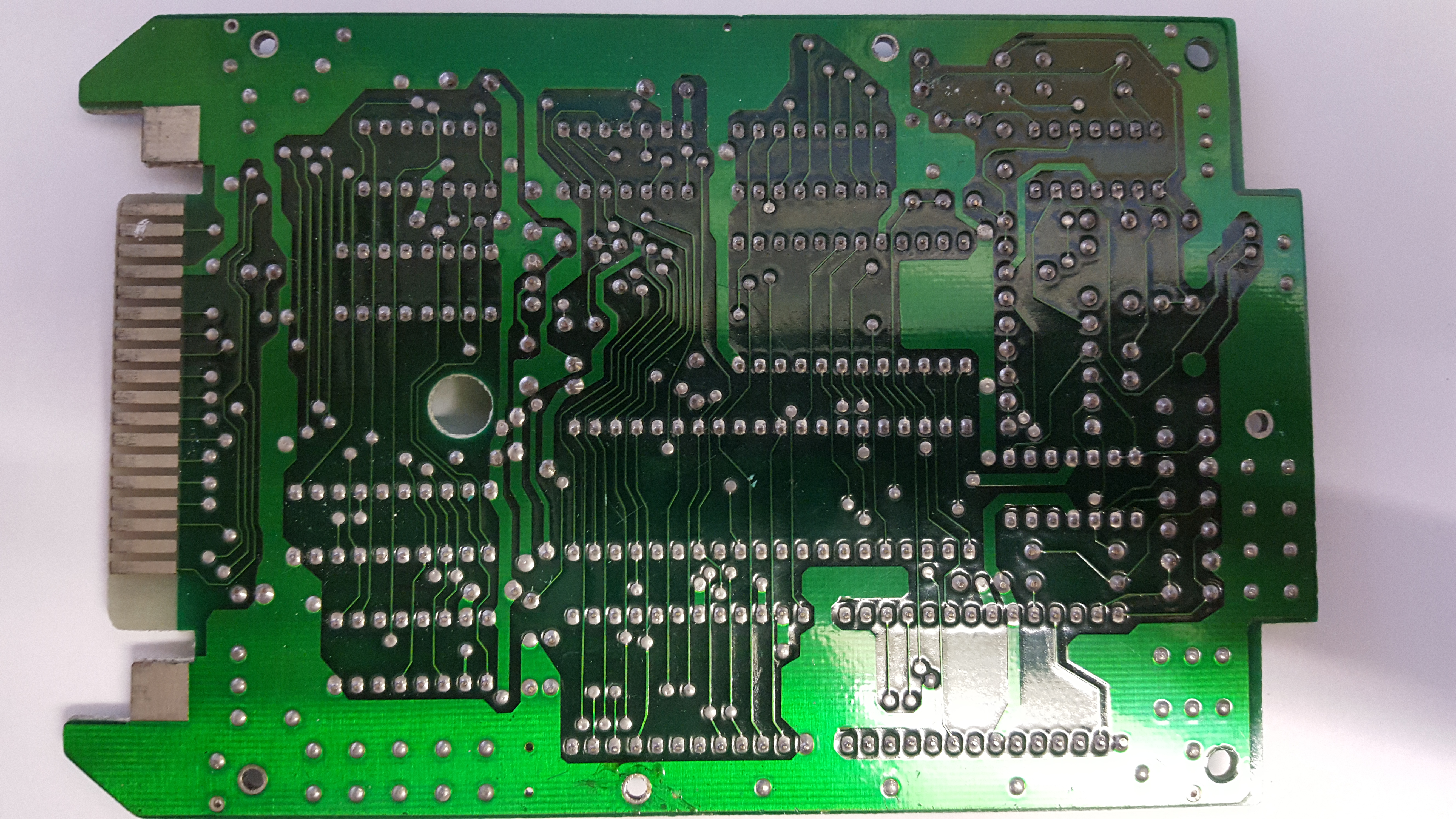

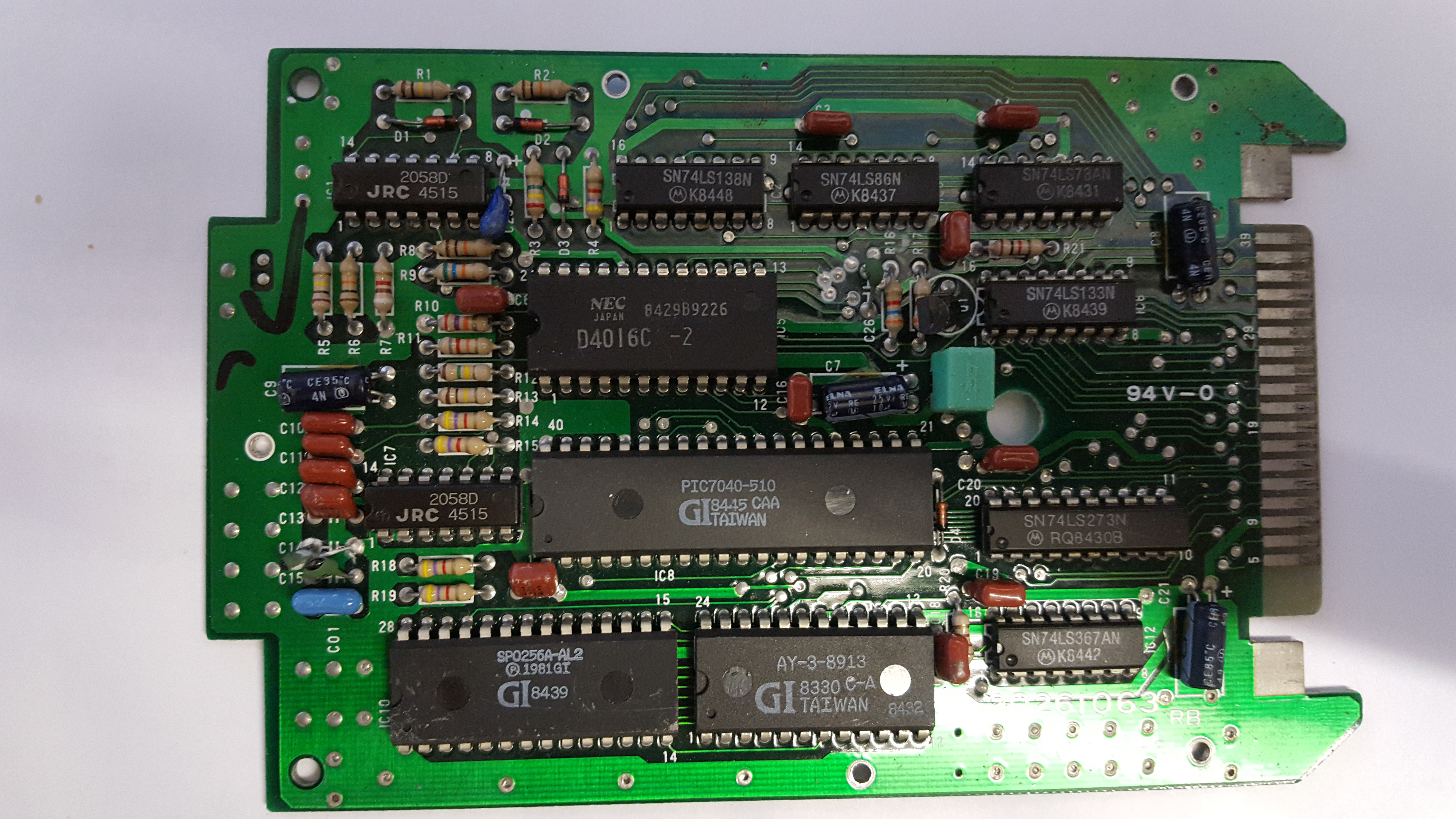

Not sure if this is Dragon compatible, but I was asked to upload images here, so here you go
- 20150806_130832.jpg (5.98 MiB) Viewed 3795 times
- 20150806_130824.jpg (5.81 MiB) Viewed 3795 times

It looks quite interesting. There is a similar cartridge for the Dragon but I'm not aware of anyone who has it, so yours may be useful for studying it.

There's stuff on the internals of the one I have here:
http://tlindner.macmess.org/?page_id=96
The PIC7040 is a microcontroller, apparently. Something I read said it was a ROM, but it's a microcontroller with built-in ROM. There's no ROM to extend BASIC. There's a dump of the microcontroller's ROM on the above link. I think someone would have to be really keen to try to reproduce this... It looks quite different to the Dragon Speech & Sound cartridges listed on this site, although it uses the same type of key ICs.
