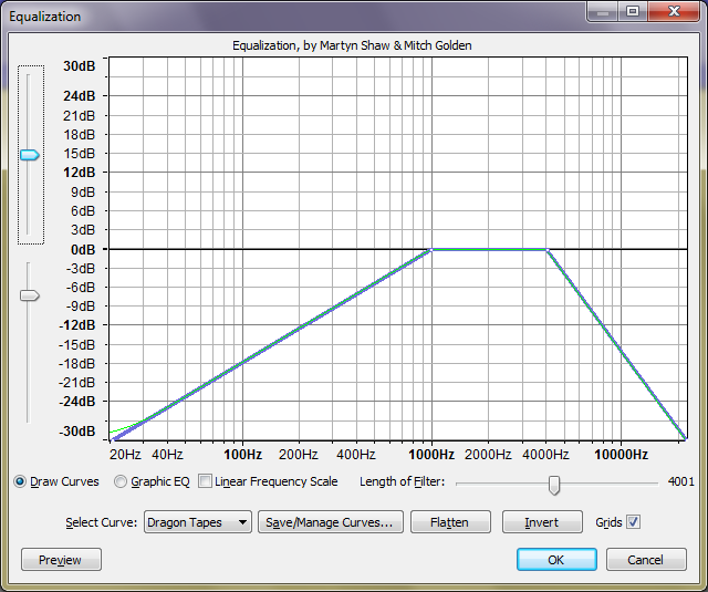

Most of them are checksum errors, but the output cas file that the program generates doesn't even show the program name on XRoar when trying to load it
Fortunately we have in the Archive a WAV and a CAS file that work perfectly and show the graphics credits page.
The WAV, that loads well on a Dragon, fails to load in XRoar, despite using the -no-tape-fast option, it simply hangs on a white graphic screen
It seems that there is some kind of error that doesn't do the same action on XRoar than it does on a Real Dragon (?)
I am sorry for not being of any help on this
Posts: 1663
Re: Horace Goes Skiing
Thanks for trying!
Any bit of information could lead to the solution.
Regards,
Posts: 1443
Sample rate converting to 9600Hz gets me a file that loads in XRoar, but it won't tape-rewrite...
Posts: 1663
This gets interesting by the minute! :mrgreen:
I was wondering if for such difficult games, we could build a device attached to the cartridge port that would give us advanced dumping capabilities.
Posts: 1663
I asked a friend of mine, which told me to filter the wav file with Audacity, and guess what? It worked flawlessly!
You can find the .cas file it its wiki page.
Posts: 1443
I guess that orange pixel in the "H" of the loading screen is there in the original then!
Posts: 1663
Yep, you are right!
If it can be of use, I can make a video of the game loading on the real machine.
Cheers!
Posts: 1793
Hello Rob,
out of curiosity, what filter did you use in Audacity ?
thanks a lot
Posts: 1663
Effect->Equalization, with parameters as shown on the attached image.
