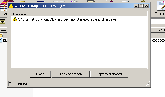

The zip archive is corrupt (WinRAR reports: unexpected end of archive).

Heh heh, it's fine. You're too quick, the upload hadn't finished. It's a big file man. It's all up there now.
