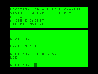

repaired games from bad tapes
another one found, and removed from the missing list.
- pharaoh's curse.png (2.58 KiB) Viewed 25097 times
Pharaoh's Curse (Apex).cas- (9.52 KiB) Downloaded 1048 times

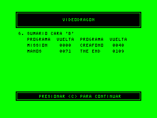

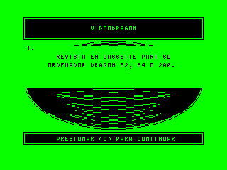

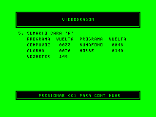

La Voz De Su Dragon.
The original tape WAVE has Spanish speaking audio between the programs.
These are just the edited programs in CAS format. (without the Audio parts).

This one feels a bit pointless, as the instructions are narrated during the load.
That’s why is was uploaded only as a wav file. Otherwise you’re losing part of it, which is not acceptable from a preservation point of view.
I mean, it’s called “Your Dragon’s Voice”, if you take the voice away it makes no sense.
So it’s not repaired (but the contrary) and it’s not a bad tape either.
the forum "Topic Name" maybe misleading.
but like i said in the post...
it's just an alternative edited CAS version.
and for ME, the Spainsh audio between loads is pointless.
