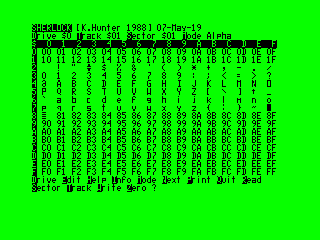

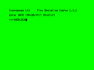

while testing FLEX programs, i noticed Sherlock disk detective v2 (Orange) didn't work.
Not sure if it's a USER error or not. :P
i did manage to deprotect the file with a simple 1 byte HEX edit.
and copy it to a FLEX OS disk.
Dragon64 machine/config only.
type BOOT
enter date, then type SHERLOCK
Sherlock - the disk detective #0002 (1988)[+flex].dsk
(180 KiB) Downloaded 1126 times

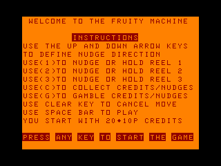

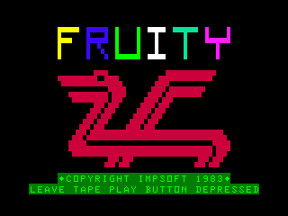

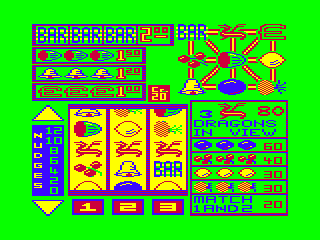

Fruity (Impsoft)
fixed 3 problems with this bad dump.
Loading Screen - fixed bad "R" graphic.
Instructions - fixed typo WELCOMBE = WELCOME.
Game - fixed corrupt Reel graphics.
Fruity (impsoft)[fixed].cas
(32.35 KiB) Downloaded 1122 times

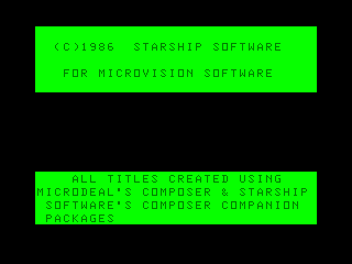

repaired files on this music demo disk.
looks like Microvison put a auto boot loader on the disk after creation, which corrupted the CASCADES.BIN file.
The Pulser version is full of corrupted files and is missing the MENU.BAS and ENVELOPE.BIN.
This version is ok and has the boot loader intact.
EL-PEA (1986)(Microvison)[f].VDK
(180.02 KiB) Downloaded 1146 times
