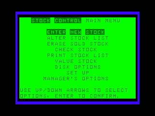

login passwords for Business Pack [stock control disk] (P.S.E and Pulser Software).
System Manager = PASS1
Standard User = PASS2

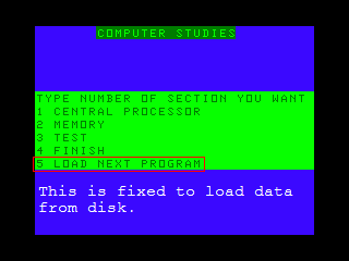

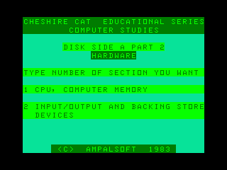

Computer Studies (PSE / Pulser) disk.
The original disks were obviously created from the cassettes.
and it looks like that tape/disk transfer failed on a few bytes, causing typo's and errors.
compare the PSE and Pulser dump of disk 1 to show a few problems.
also 1 cassette load command was left in the BASIC so it didn't load from the disk menu.
this has been fixed.
just for cosmetic purposes i edited the CASSETTE title screen text to DISK. :D

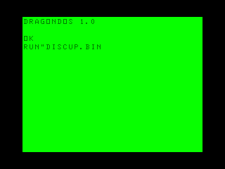

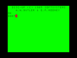

a few parts require DISCUP to load on Dragon64,
so i put that on the disk as well. ;)
RUN"DISCUP.BIN"
BOOT
Computer Studies [discup fixed].zip
(78.21 KiB) Downloaded 1229 times

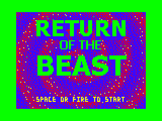

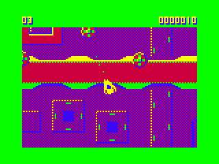

Return of the Beast - Demo (2014)(Orchard, S)
The CAS file loader doesn't work in emulators.
dumped the code from the WAV (which did load).
And created a 'normal' CAS file from it.
I also found an alternate (possibly updated?) BIN file online.
so created a working CAS file from that as well.
return of the beast.png (2.84 KiB) Viewed 46053 times
return of the beast_1.png (4.97 KiB) Viewed 46053 times
return of the beast_2.png (2.45 KiB) Viewed 46053 times
Return of the Beast - Demo (2014-2017)[from wav].cas
(24.38 KiB) Downloaded 1247 times
Return of the Beast - Demo (2014-2017)[from web].cas
(24.37 KiB) Downloaded 1219 times

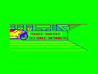

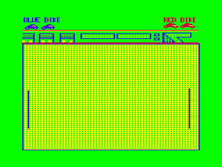

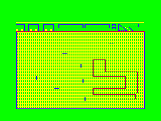

Trace Race/ Trace Racers (Cable Software)
The archive only has the SOLO (1 player game), which is also incomplete and bugged.
this is the complete version.
Side A (solo) - 1 player version
Side B (trace) - 2 player version
*you will die, if you let go of the joystick.
trace racers.png (2.25 KiB) Viewed 46038 times
trace racers_1.png (2.15 KiB) Viewed 46038 times
trace racers_2.png (2.26 KiB) Viewed 46038 times
Trace Race (Cable Software)[2 parts].zip
(16.08 KiB) Downloaded 1250 times

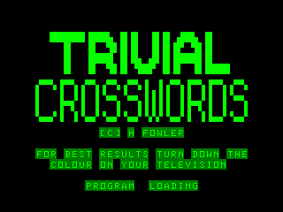

found yet another version of Trival Crosswords.
the data blocks are identical, but main file and loader are very different.
no company name (Quickbeam) is mentioned. only the programmer.
Trivial Crosswords (1986)(H. Fowler)[alt].zip
(83.72 KiB) Downloaded 1250 times

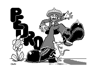

Pedro - just fixed so it will work in MAME.
it uses the exact same loader as BC Bill.
MAME doesn't read the short block (249 bytes) of data correctly.
when the data block is resized to 256 bytes... it works.
Pedro (1984)(Imagine)[mame fix].cas
(37.12 KiB) Downloaded 1241 times
Posts: 1711
Which is weird because as far as I remember, this loads in a real Dragon.
