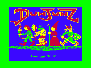

Title: Dunjunz
Author: 2017-2018 Ciaran Anscomb
Publisher: 2018 Teipen Mwnci
Platform: Dragon, Tandy CoCo 32K
Run.tape: CLOADM
Run.dragondos: BOOT
Run.rsdos: DOS
Alternate (also working in emulator) version of Dunjunz.
the version in the archive does nothing in MAME or Xroar.
*MAME only works in Dragon 64k.
not touched by me, sourced online. 8-)
Dunjunz-1.1.zip
(201.1 KiB) Downloaded 892 times
Posts: 1484
Heh, yes, I've tried to get Dunjunz replaced behind the scenes... The CAS on the site should work with anything as it's generated to include a slow normal loader if read naively with CUE data that overrides it to include the faster loader that's on the tape. And that's the official CAS ;)
If you want to distribute something extracted from the tape itself that'll work with things that don't support CUE, it'll have to be a WAV...
Edit: oh, that's weird about MAME Dragon 32. I'm reasonably sure it works on a real one...

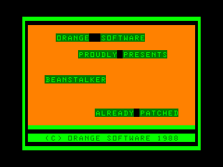

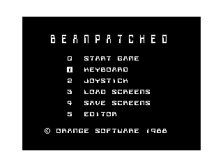

Beanstalker [Patched] (Orange)
*this is not the separate patch tape.
Beanstalker Patch_3.png (4.63 KiB) Viewed 20300 times
Beanstalker Patch_1.png (2.7 KiB) Viewed 20300 times
Beanstalker Patch.png (2.45 KiB) Viewed 20300 times
beanstalker-patched.cas
(32.67 KiB) Downloaded 920 times

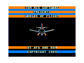

here's one that failed to load in MAME.
Worlds of Flight (1984)(Microdeal)[f].cas
(32.47 KiB) Downloaded 868 times
