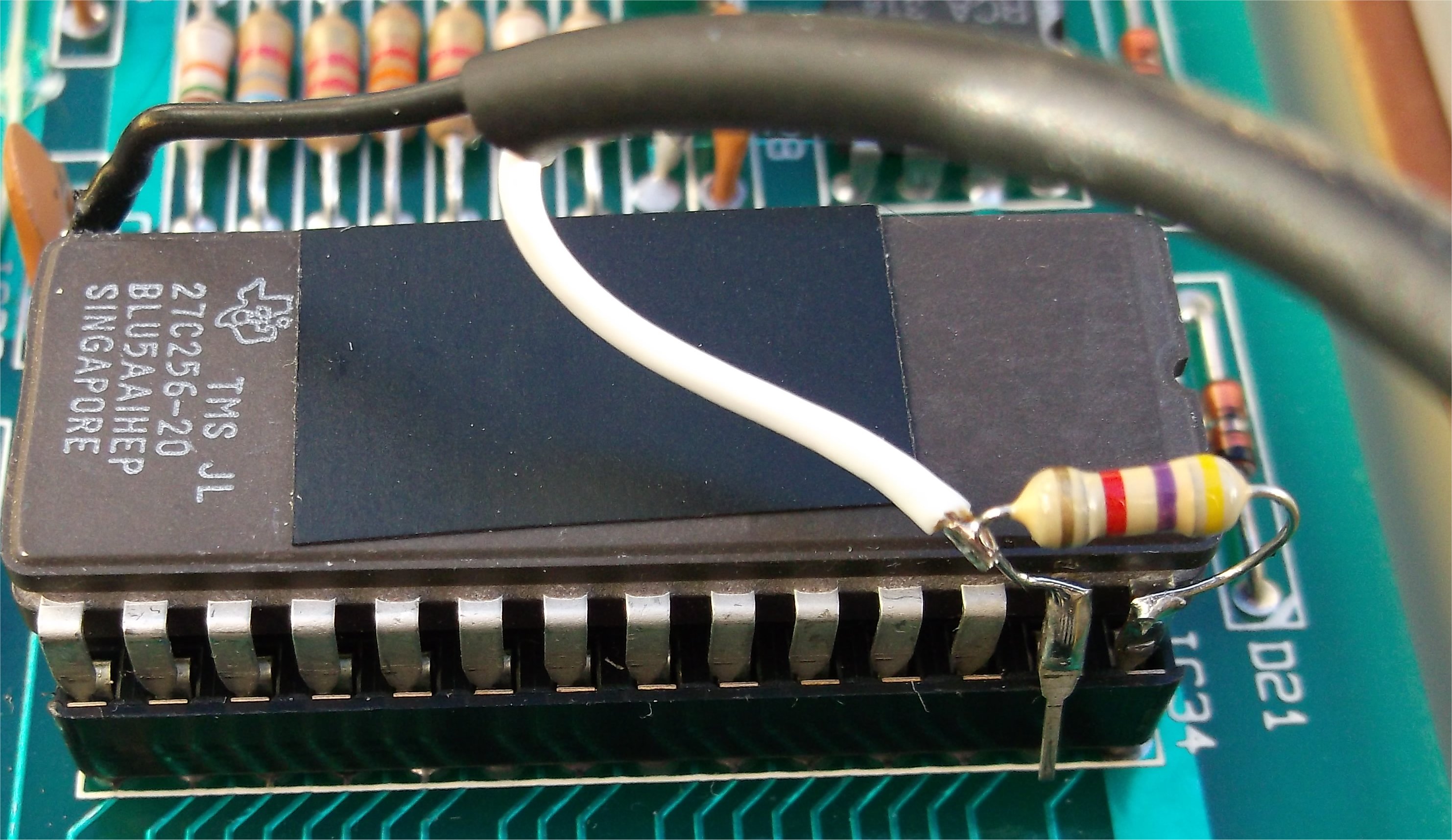

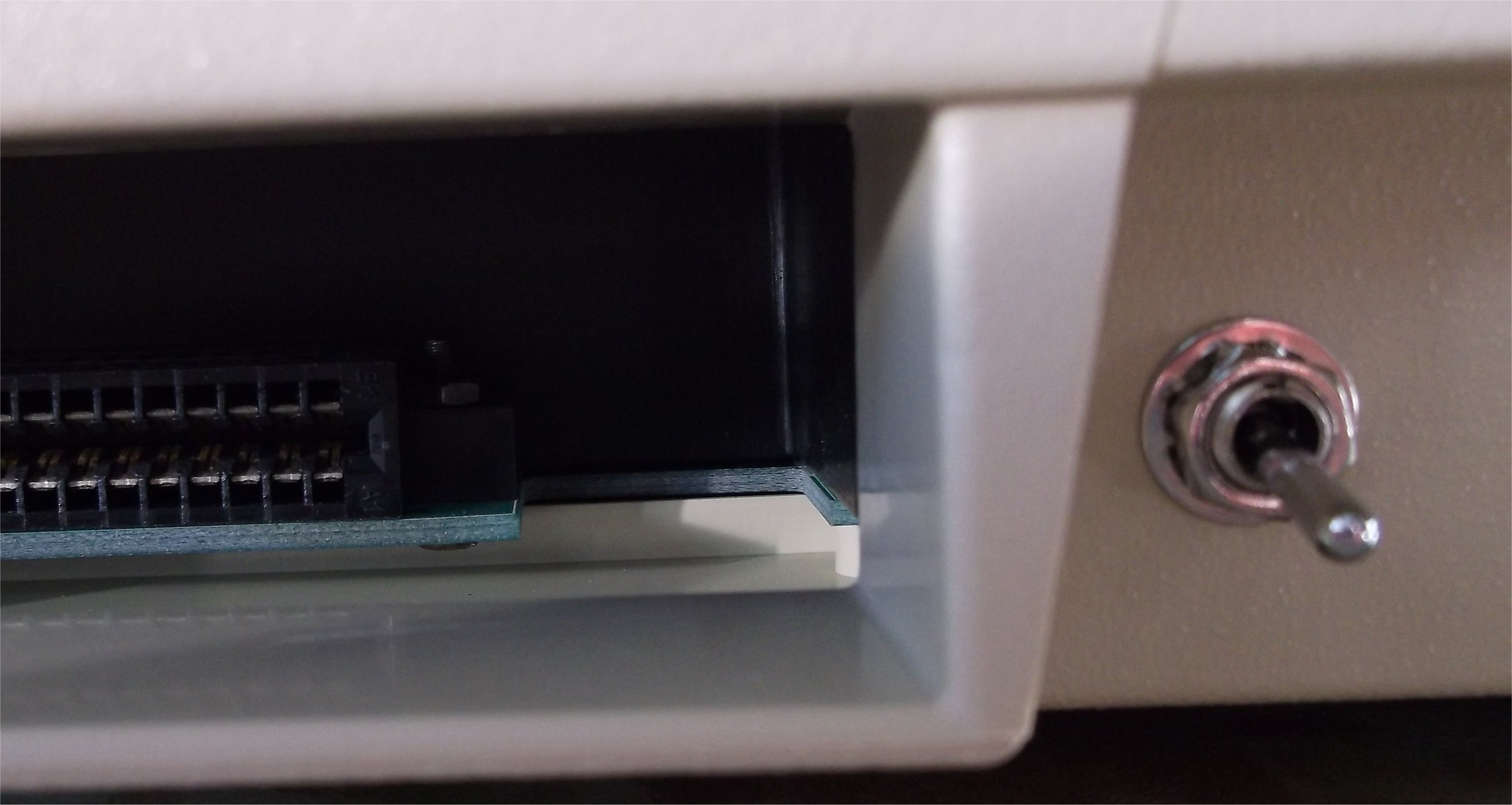

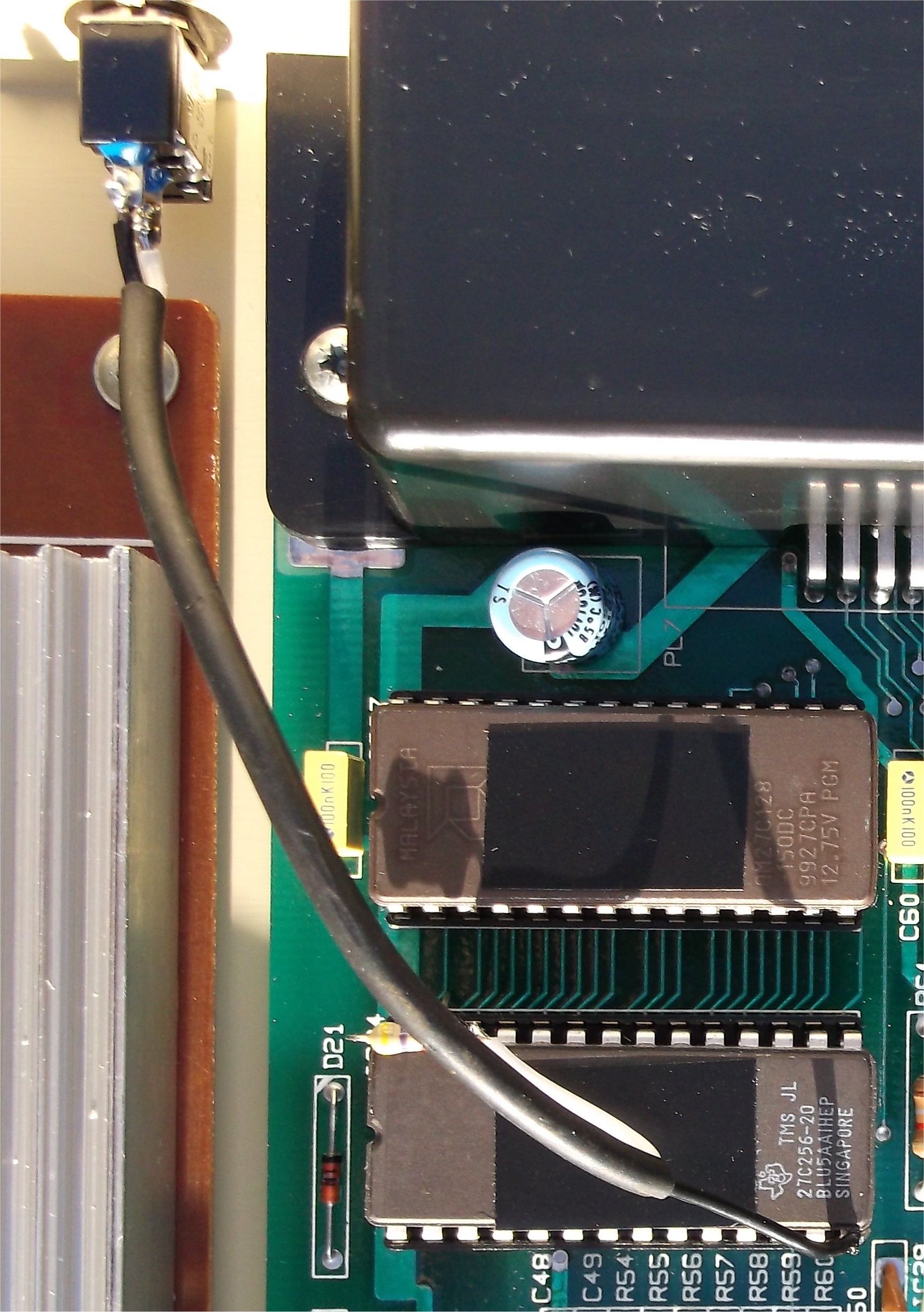

The attached ROMs are intended for use with the Dragon 64 to give a dual-boot (Dragon 64/CoCo 2) feature. They are intended as an alternative to this method with the added advantage of keeping the 64 mode BASIC. To use them you will need a 27128 EPROM (for the Dragon 64 "64 mode" ROM) and a 27256 EPROM (for the combined CoCo 2 and Dragon 64 "32 mode" ROMs). You will need to isolate pin 27 (A14) of the 27256 EPROM from the PCB and add a switch (or jumper) to switch between CoCo and Dragon mode ROMs. See the following attached pictures for a working example of the modification.

There is no need to de-solder the switch or resistor if you have already done the modification to your Dragon 64. I did the update as follows.
(1) Remove the EPROM (IC18) with switch and resistor attached.
(2) Make sure the switch is in the OFF position, and put the entire assembly into your EPROM eraser.
(3) Make sure the switch is in the OFF position, and place the EPROM into the ZIF socket of your EPROM programmer.
(4) Re-program the EPROM with the updated ROM image.

Here you can see photos of the modification I made to my own Dragon 64.

Dantyr wrote: Question: The position where I put the switch will impact the insertion of any original Dragon cartridges or interfaces ?
Yes. It looks like you will need to move the switch.
