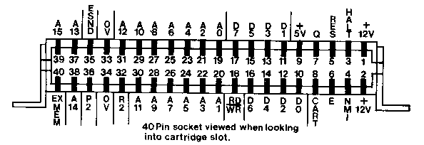

Attached below is a diagram of the Dragon (and CoCo) cartridge port. It clearly shows the CART line which you need to cover on the cartridge to stop it from auto-starting. If you turn the cartridge upside down, the CART track would be the fourth from the left. The first first three tracks are missing on some cartridges, so usually the first track will be the one to stick the tape over.
