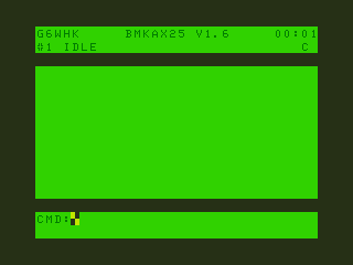

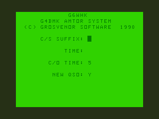

Success! The ROM is definitely encrypted.
The address lines A0 and A1 are swapped, and the switch selects which half of the ROM is addressed with line A14.
The data lines are also swapped in order MSB 3, 2, 1, 0, 7, 6, 5, 4 LSB.
