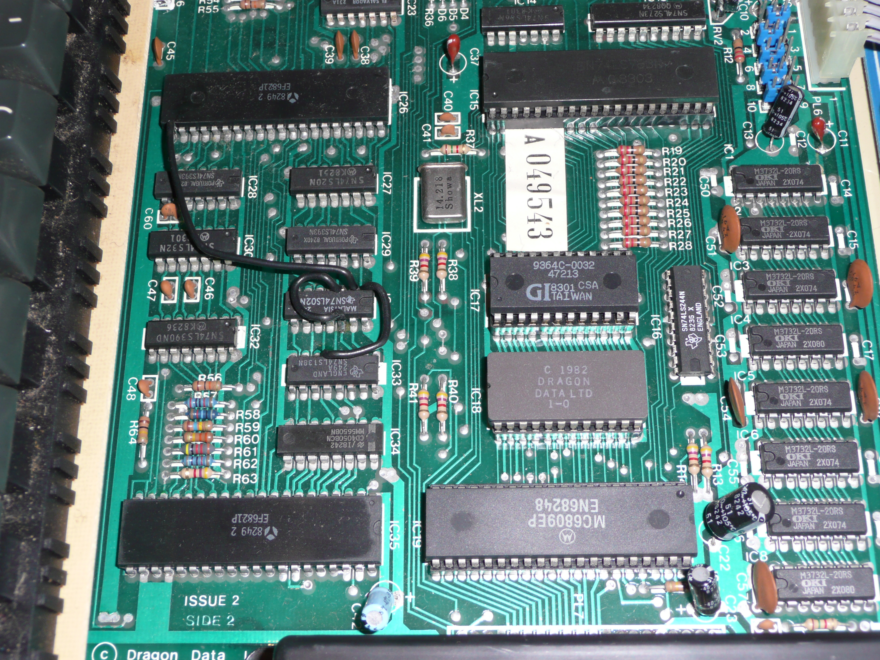

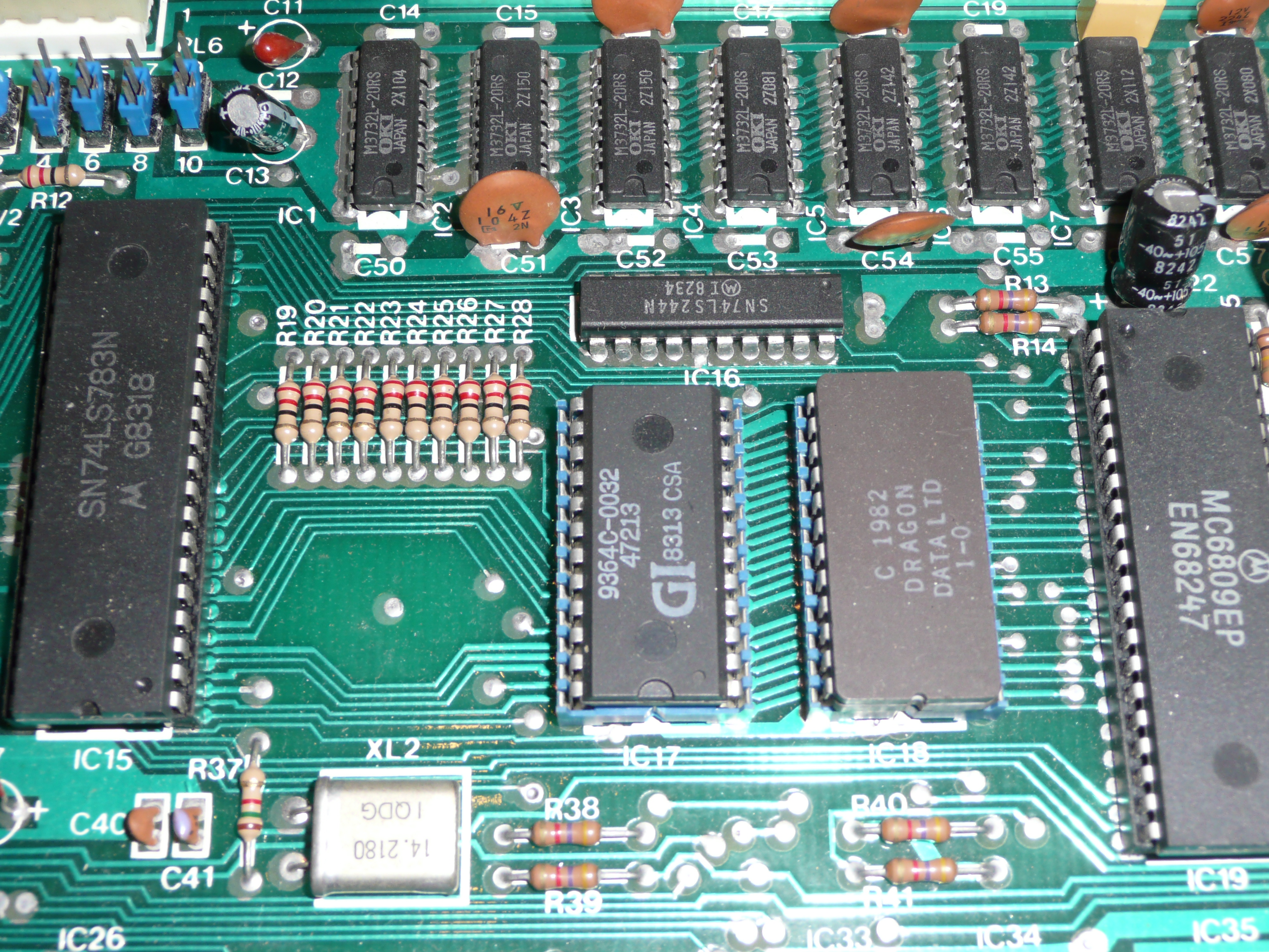

Re: Katerpillar Attack Cartridge for the Tandy CoCo
Hi Rolo,
I have one D32 older than yours, but the other is newer (according to the serials).
The lower one works perfect without changing any chip along the 64K, this one has serial number 064651.
The other (newer), doesn't work properly with the upper 32k, this one has serial number 318986.
You will see in the photos that both have the two ROMs socketed (IC17 and IC18).
This D32 didn't work properly in 64K
Dragon 32 modified to work with the inside 64k

Funny, old machines have everything soldered in, newer ones have sockets. Normally it's the other way round.
