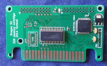

We all know 32K is enough for everybody, but... This was my Christmas present for myself: A 32K memory expansion for my Dragon 32 that plugs into the cartridge port. I can now run NitrOS-9 like on a Dragon 64!
First, after studying the 74LS783 SAM datasheet, I thought I could make the expansion card almost fully compatible with how the Dragon 64 works, enabling the extra RAM while in SAM "map type 1" (all-RAM). But after some trials and looking more closely at the Dragon 32 schematics I understood this could not work.
So instead this card adds a new "map". When poking $FFBF, it disables the BASIC ROM and the card's RAM is available at $8000-FEFF. Poking $FFBE brings back the ROM again. (This "external map" will only activate in SAM map type 0.)
This is different from a Dragon 64:
  • Video RAM access must stay in the lower 32K (because the 6847 VDG can only reach the internal memory). So for instance NitrOS-9 needs a small patch.
  • The 32K cannot be swapped into the lower 32K (because the cartridge cannot disable the internal lower 32K on writes). Very few 64K programs use this "page" switch on the Dragon 64.
  • To go 64K RAM, poke $FFBF instead of $FFDF. NitrOS-9 needs this modification as well.
The card should be of interest to hard-core Dragon 32 owners who are interested in NitrOS-9 but find 7K of available memory a little tight :) Of course, DriveWire becomes important since the card occupies the cartridge port.
It can also be used on a Dragon 64 to have a total of 96K RAM. But there is no software (yet) to use it. If someone ports Fuzix to it, they'll have free boards :)
There are some unpopulated headers and spare signals for use as a development board. It is made more in that spirit than a "consumer" product.

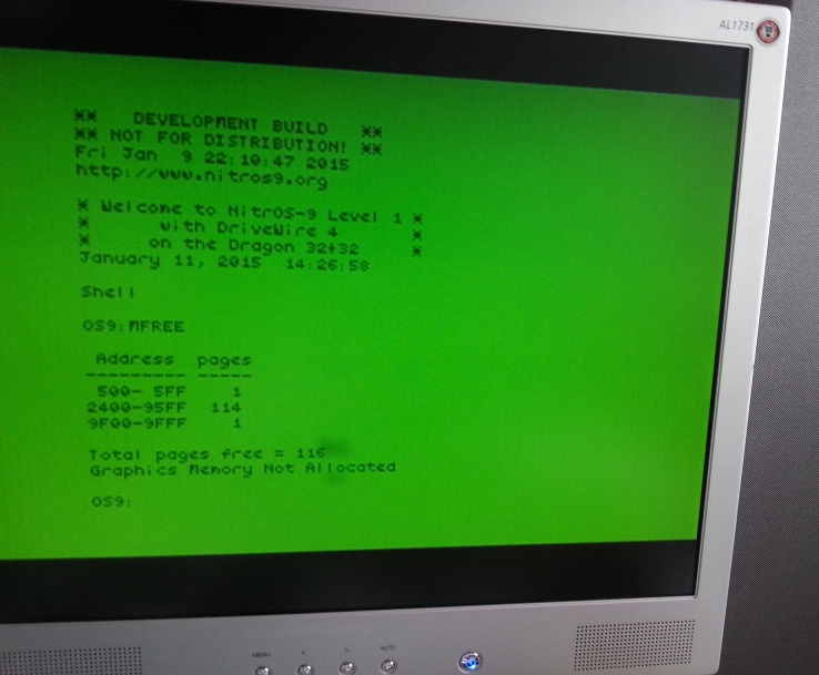

Yes, I use the EXTMEM signal (a.k.a. SLENB or DSD) to disable internal devices when the cartridge memory is active. Unfortunately EXTMEM doesn't disable writes to DRAM, which are clocked in directly by the SAM. So any external memory device must stay in the memory space where the SAM believe there is no DRAM (above $8000 and only in SAM map type 0). A MMU with full 64K spaces like on the CoCo3 and used by NitrOS-9 Level 2 just cannot be done externally. It wouldn't take much internal surgery to gate the DRAM writes but then there wouldn't be much point in an external upgrade... For Level 1 however this cartridge gives you the full experience.
It is really nice to be able to configure the logic on the 9572 after the PCBs are ready and some testing can be done. Actually I didn't prototype it, it just worked :ugeek: Currently I am pondering if I should add some "half" modes where only C000-FEFF is active, or maybe even E000-FEFF. Or a software-enabled write lock for BASIC/cartridge ROM emulation, although marginally useful, it would be a feature you don't have in "all-RAM" on a Dragon 64.
Obligatory screenshot
