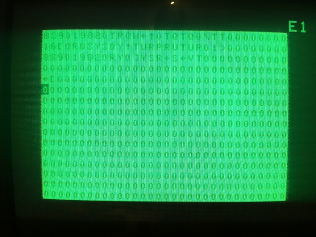

Thanks to a very helpfull Answer to my Topic and to my collegs in my Company i now have a connected Monitor and a new PSU for my Dragon 64.
Bute when i start the Computer the Screen looks rubbished.
So, the Cursor is there and works so far as i can type in chars with the Keyboard.
But it wouldn't print the right char corresponding to the written char on the cab.
So, can someone help me with this? Would be really great to get the Dragon up and running.

Re: Problem with Screen on Dragon 64
Given it's all otherwise working, this more looks like a problem with the data lines to the VDG. In this case, D4 in particular looks stuck high. I'd first check the connection between pin 7 of the VDG (IC10) and pin 5 of the buffer chip in front of its data bus (IC20).
If that looks fine, the other side of the buffer chip is pin 4 - maybe check connectivity between that and the Dout from the appropriate RAM chip (or 17 of the similar buffer before the CPU's data bus - IC25).

Hello. Thanks for your Advice!
I tested connection between IC10 Pin7 and IC20 Pin5 and it's OK.

Sorry i am a beginner in repairing Computer. Could you be more accurate by that? Would be very kind.If that looks fine, the other side of the buffer chip is pin 4 - maybe check connectivity between that and the Dout from the appropriate RAM chip (or 17 of the similar buffer before the CPU's data bus - IC25).
Just a short Information, it looks that only the Output is wrong.
when i type in "?mem" it shows "?]U]" but when i hit Enter, the Screen prints "24871".
Is a can tell from Videos i saw, this should be correct.
Also when i etner "exec" to switch to 64k, it shows "UXUS" and the "?mem" shows "41241" after that.
So i think that on the way to the Screen the Output gets rubished.
Regards Andreas
Hey there.
So, i disassembled the Mainboard amd cleaned it a little bit. After that i put it back in the casing nad turned it on.
Still no difference so i leave it running. After a few Minutes the picture just turned right. From one Moment to another.
Don't know what happened. I tried tuning it off and on again and still the Picture is good.
So, someone has an explanation for that?
Maybe an Capacitor is comming wet again which was dry?
Or maybe a broken solder point that has come to make contact again.
The idea would be to heat the solder points with a soldering iron, to repair them.
