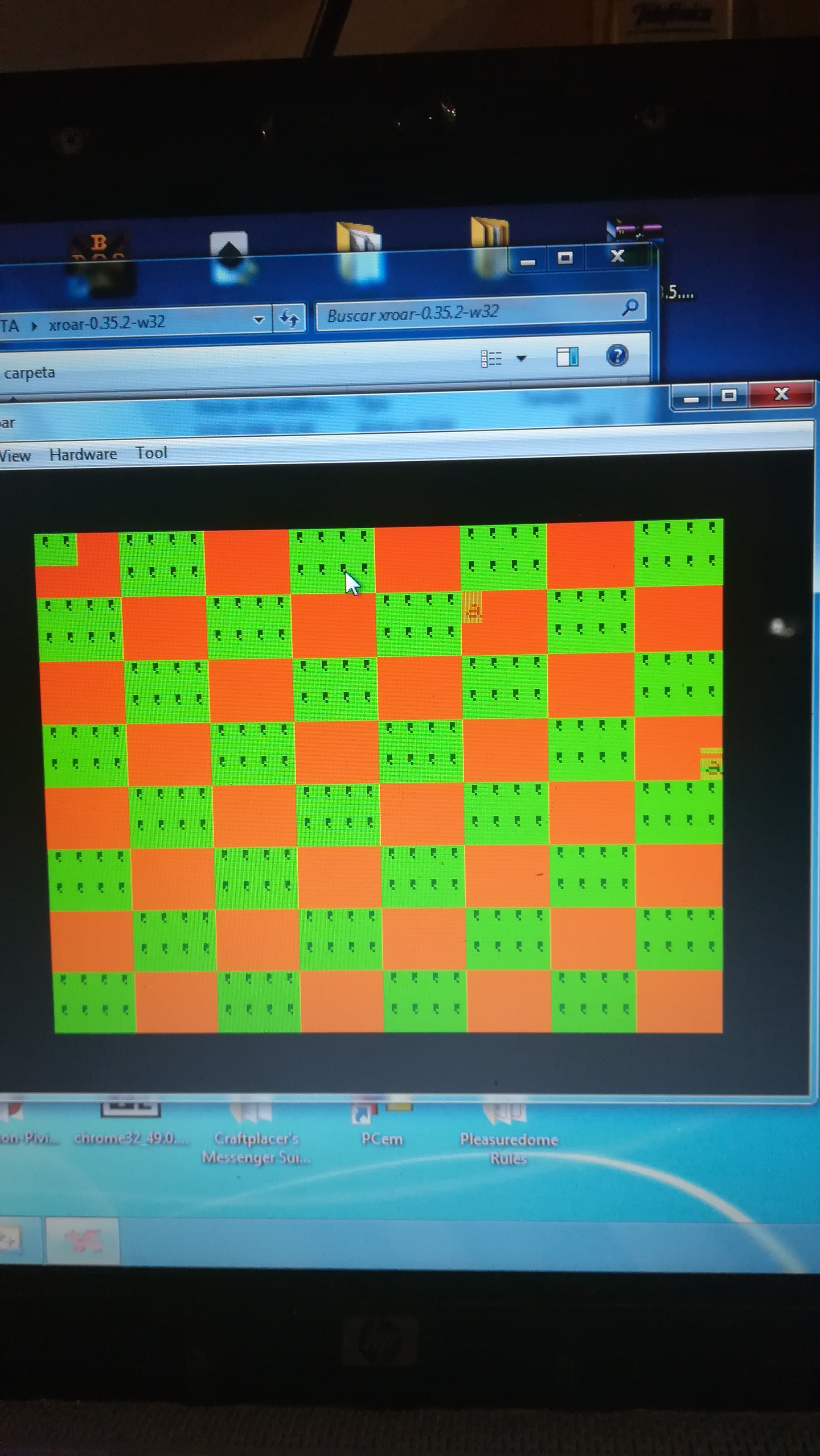

So, I rename them in a way that makes xroar happy, I go run it, select the 200E in the options... aaaaaaand it doesn't boot.
Instead I get this error screen:
I tried changing the extensions of the files to rom, creating a conf file to specify the roms manually, but still nothing.
Kinda ironic that nobody complained about this until now tbh.
Maybe I am overlooking something obvious?
If anyone can help me it would be really neat.
PD:Yes, I tried renaming the external generator rom to something xroar couldn't detect, but it gave me a different error screen instead, the one with all the @ symbols.

I think either you or I have them the wrong way around. This is what XRoar thinks:
d200e_1 ic18_v1.4e.ic34 (32K BASIC)
d200e_2 ic17_v1.4e.ic37 (64K BASIC)
dragonnostalgia
Posts: 8
Joined: Mon Feb 11, 2019 7:36 pm
Location: Argentina
Re: Problem with Dragon 200E firmware on Xroar
Post by dragonnostalgia »
Tried changing that, and it does boot up, I can use the character set for things like Ñs and stuff. One thing I can't figure out is how to do lowercase... The manual says to press SHIFT+0, but I tried that and it just prints out its respective symbol. I also can't seem to do accents.

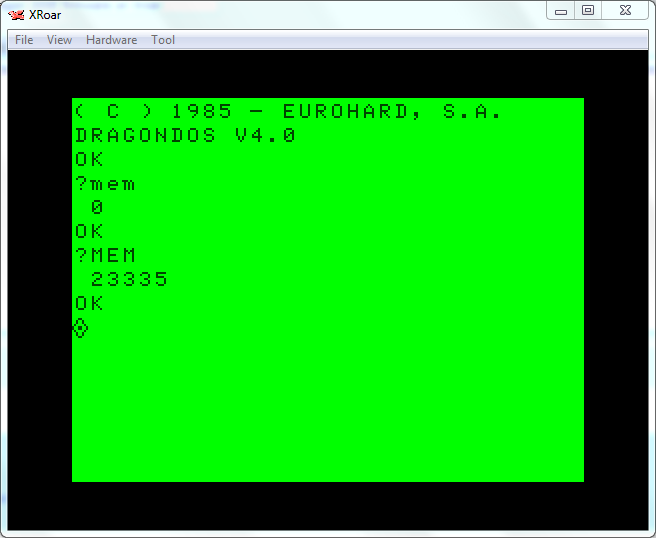

Something interesting I found is that while in the lowercase mode, if you type ?mem it gives ya a result of 0, when it should give ya the rough amount of memory you have available.
This is true in 32K mode:
And in 64K mode:
I thought it would just give ya a syntax error, because I tried running EXEC on lowercase and it gave me that exact error.
Dragons are cool and very green :P
Posts: 1160
That's actually pretty cool - unlike the "stock" BASIC, it seems you can use lowercase as distinct variables...
A=1:a=2:PRINTA,a
 1               2
Huh. I didn't knew that. Looks like Eurohard made some tweaks to this version of BASIC, beyond just adding the character set.
