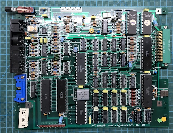

By the way, I saw in another thread that people are interested in pictures of different boards, I figured I'll post mine. It's probably common, but maybe someone will be interested.
Interestingly, one of the RAM ICs is different from the others. But I could swear I'm the first person to open this machine since it was manufactured.

Re: Help repairing Dragon 64
We have that board scanned here, but thanks anyway!
Best of luck getting your Dragon back in working condition!

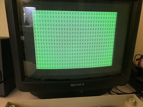

Progress update: I started removing RAM ICs, socketing them, and putting on good ones (I can go back later and put back the RAM ICs that were not defective). I did 4 of them and ran out of sockets (oops). So far no changes.
One interesting bit that I suspect you're all aware of, is that with a RAM IC completely removed, I get a screen full of characters. Different characters depending on the IC (and one of them was actually a couple of characters and some color). I guess if an IC is completely dead, that's a pattern to look out for. Also, it confirms that we're reading the ROM correctly and that the screen display is fine.
