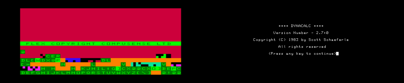

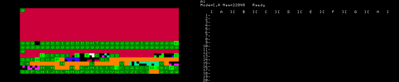

The 18spt version runs in MAME, though I wouldn't expect it to corrupt the VDG output:

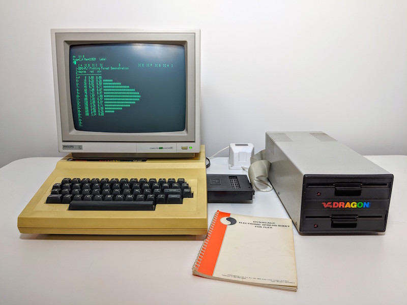

Thanks for all your help everyone - I'm up and running with 80 column Dynacalc! Come see it for real at the Meetup in a couple weeks

Can you confirm whether it corrupts the VDG output as in my screenshots, or do I have an emulation issue?
Re: Flex Software for the DragonPlus
It corrupts in exactly the same way! Maybe Flex presumes it's safe to write to that memory, now the 80 column card is running.
