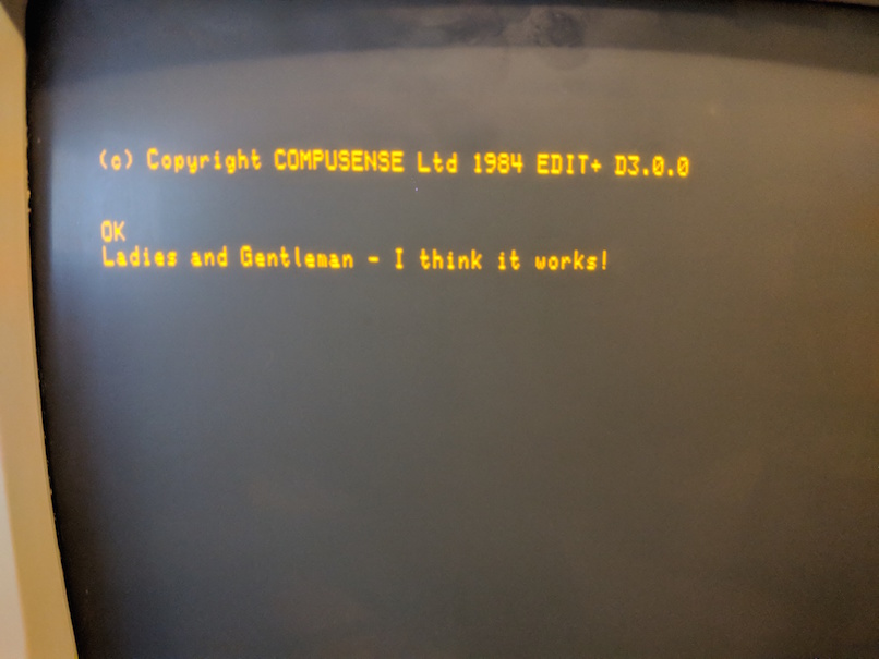

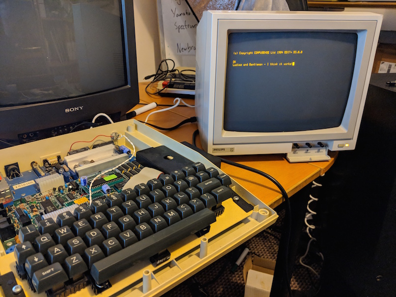

Next I plugged in my new dinky little monitor, but still nothing - but now I suspect there's an issue with Flex and the fact my machine is 32K. So as @robcfg suggested, I tried Edit+, and oh my gosh, it actually works! (I don't know how to use Edit+, but I can come back to that).

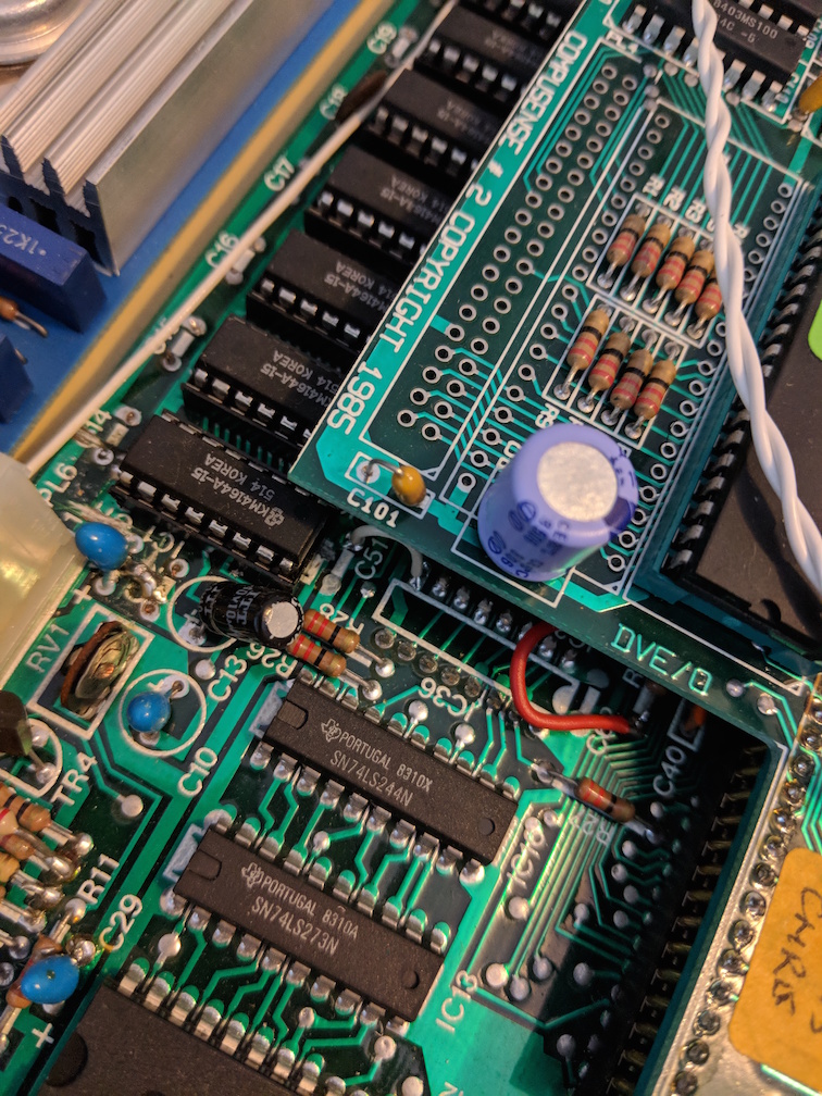

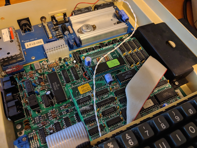

Well, I'm confused. This is the problem with the machine being in my office, and I'm supposed to be at home with my family - there's only so many times I can 'pop out to the shops' and quickly nip into the office to check things! And it means I miss stuff ...
It now looks like my machine might be 64K after all - an eagle-eyed reader on Facebook noted that my RAM chips are socketed, and indeed they are. Closer examination shows that the second row of RAM chips have been removed too (see photo below) and the new chips are KM4164As - which would imply 8 x 64K = a 64K Dragon. I'd like to prove this, but I'm not sure how - I guess I could write a small m/c program to switch the ROM out and see if there's RAM there (hunts for reminders on how to do this).
But ... if it is a 64K, my nice simple reason for Flex not running (I don't have enough memory) disappears and means I need to do more digging. Oh well!
As ever, any pointers or suggestions gratefully received!
