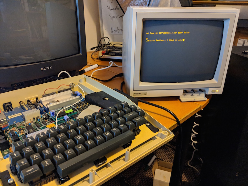

Right, now off to the museum to scrounge a monitor, just to double check that's not the problem.
Posts: 372
Re: Attempting to get a DragonPlus board going ...

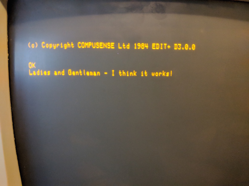

Okay everyone, lots of progress!
First off, my machine *is* a 32K system, which surprised me. The advert http://archive.worldofdragon.org/index. ... onplus.jpg says 'requires a 64 Dragon', but the installation notes http://archive.worldofdragon.org/index. ... rams02.jpg say "is fully compatible with both 32K and 64K Dragons".
Next I plugged in my new dinky little monitor, but still nothing - but now I suspect there's an issue with Flex and the fact my machine is 32K. So as @robcfg suggested, I tried Edit+, and oh my gosh, it actually works! (I don't know how to use Edit+, but I can come back to that).
So now I'm wondering if the reason Flex didn't work is because this isn't a 64K machine. Now, I don't want to break this machine by removing the board and testing it in the 64K, so I'll see what I can work out with an emulator. @pernod70 - I know absolutely nothing about Mame - how would I get an emulation of a DragonPlus system up and running?
Thanks for your help and suggestions everyone - I think this is the first time I've ever seen a real, running DragonPlus board!
