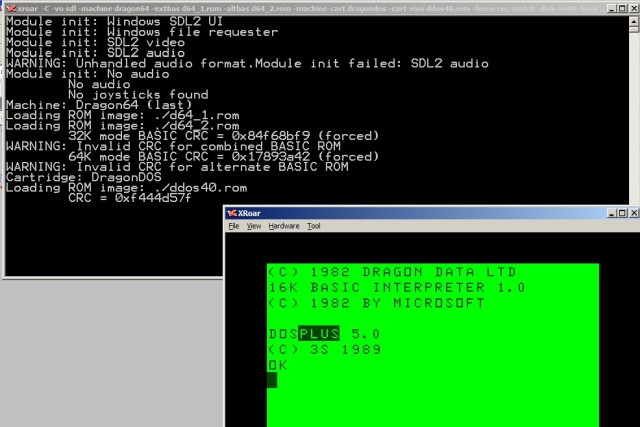

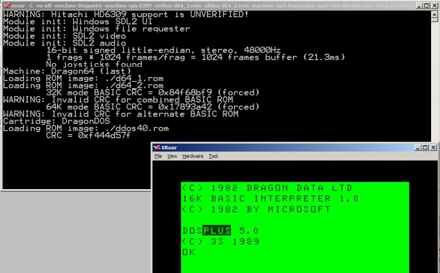

Re: XRoar and sound
for maybe it could help, I attach here the debug windows of both snapshots
The last one fails lading the SDL2 audio ...

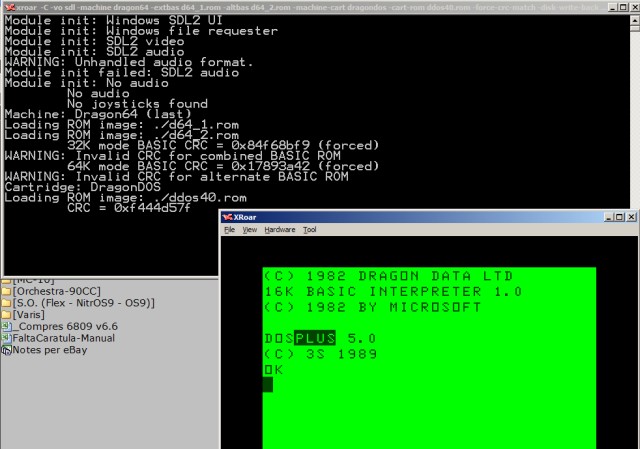

Re: XRoar and sound
Thank you for all the testing here...
Ok, in 2017-49598 that warning is a bit more informative - it definitely still won't work, but let's see what audio format is actually failing here. It *should* be defaulting to the native signed 16-bit format.
Also, as a workaround, maybe try "-ao-format s16" or "-ao-format u8".

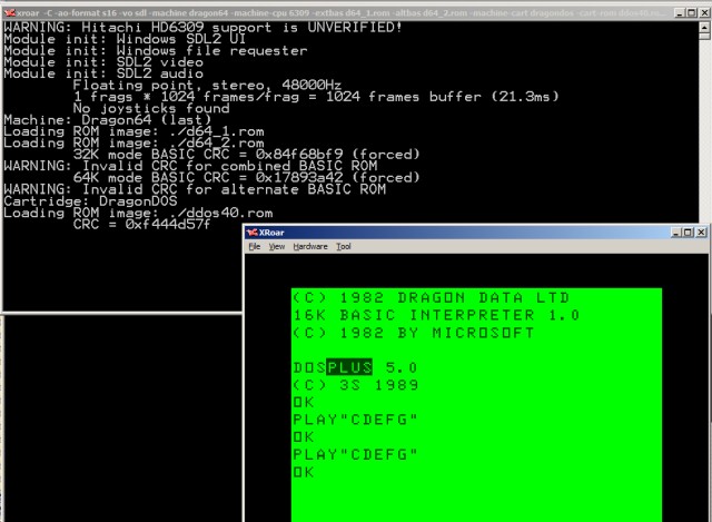

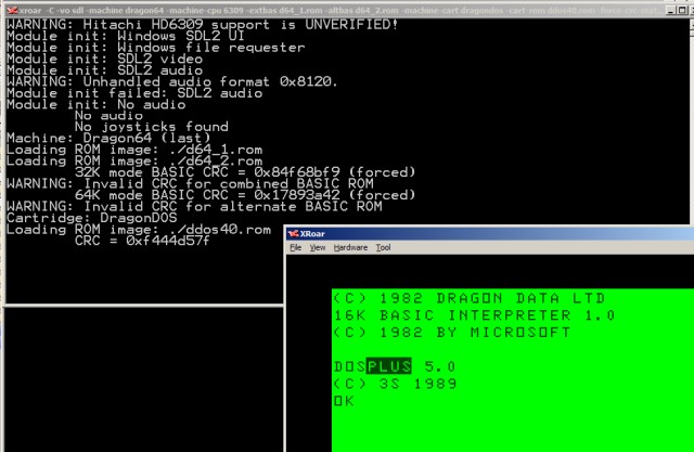

Re: XRoar and sound
not good luck
Atached is the debug window.
None of the two possible workarounds do generate sound
not good luck
Re: XRoar and sound
Ok... 0x8120 means floating point audio. XRoar is requesting 16-bit signed native-endian by default, and is being told to use floating point. Interesting! I wonder why that has started happening...
So the core already supported floating point, I've hacked in support to the SDL driver. See how 2017-49609 goes?
